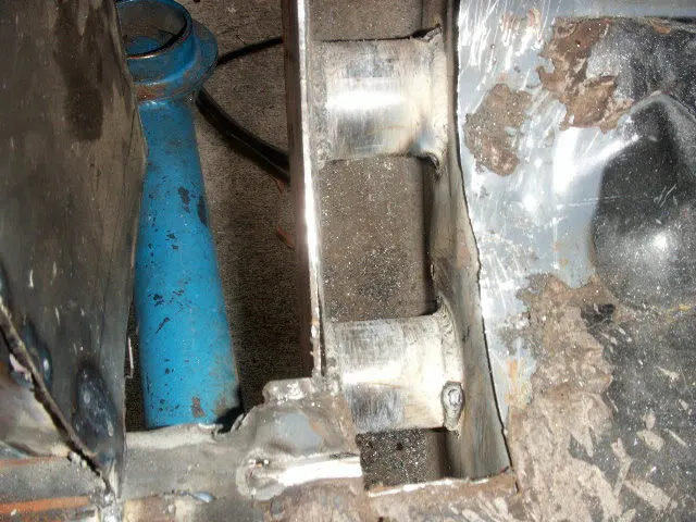

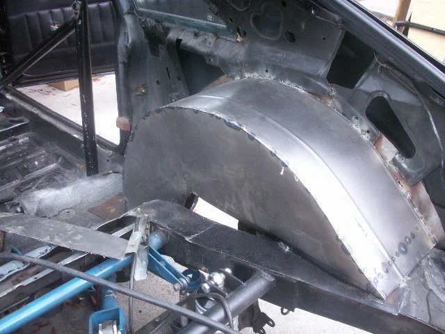

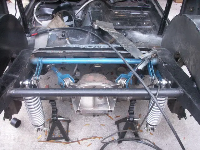

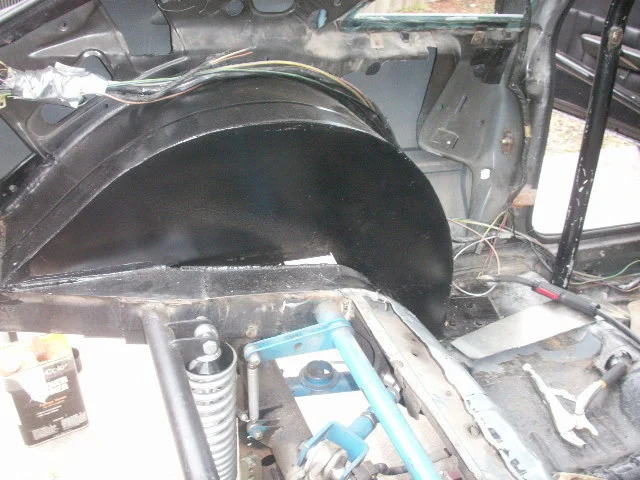

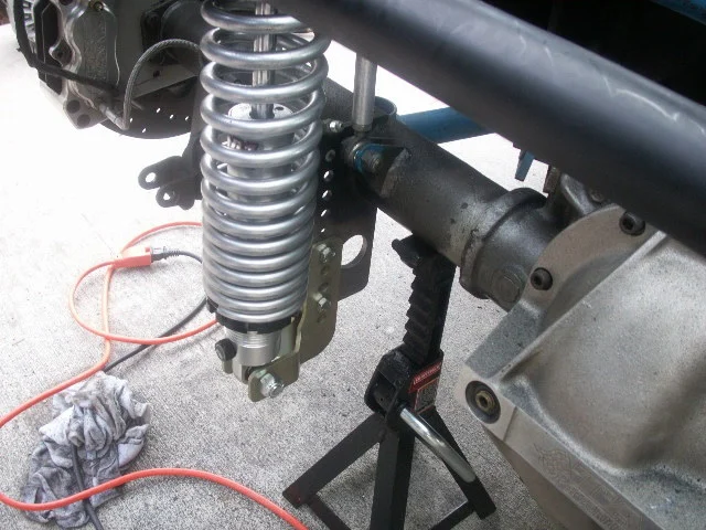

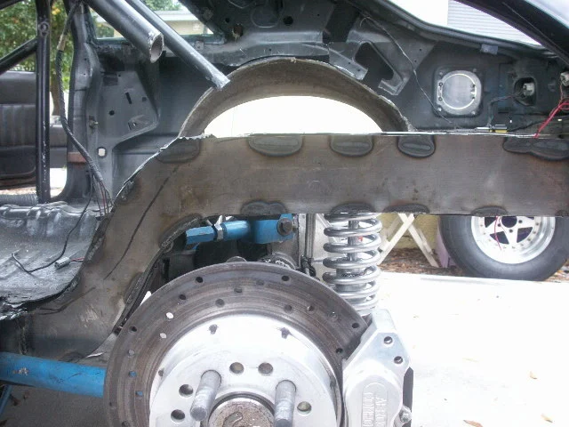

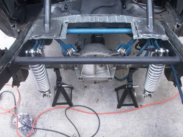

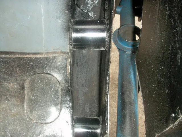

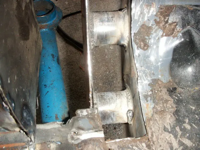

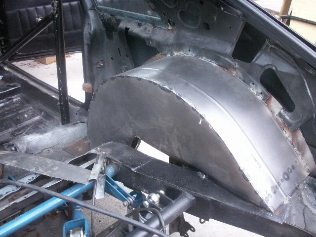

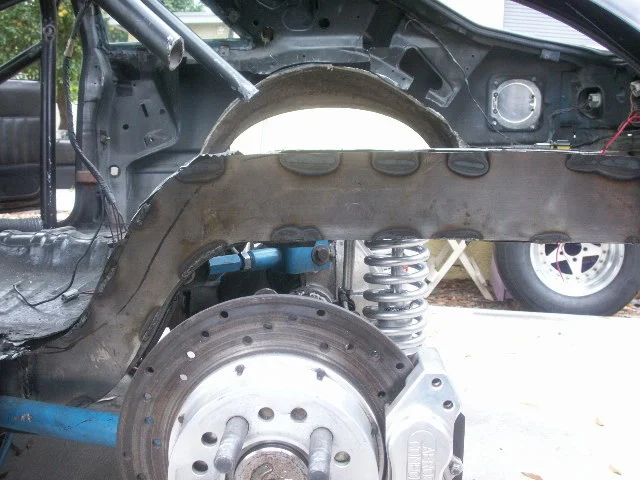

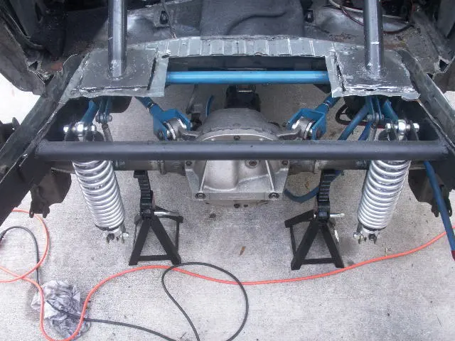

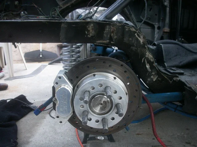

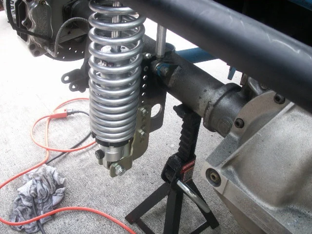

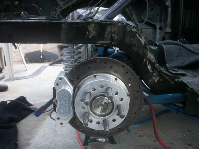

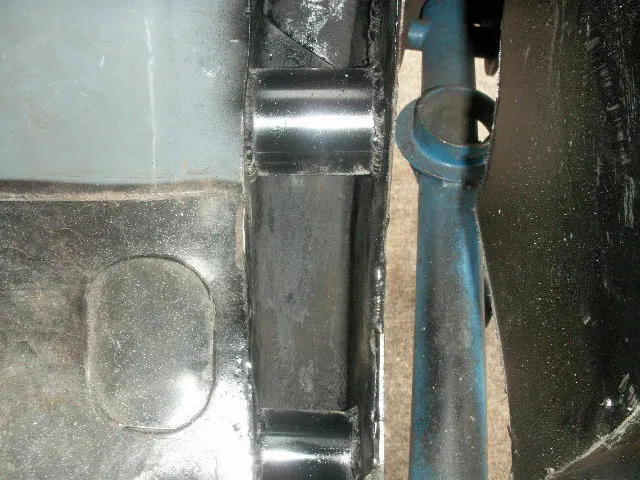

Hehe,well I got my self into a fun and interesting project.Started with swaping sub frame connectors from some old,crappy one to some new Comp. engineering ones,now its gone into full blow chassis modifications. :rlaugh:
I got to change the back seat bar on the roll cage and the to inner kickers,adding an X bar and possable making new rear bars,a funny cat cage,mini tub,coil over (with I have finished already),and possable plating the frame rails.Im also adding dual batteries go some brake work to do,need to fab up a new nitrous mounting bracket,needs a alum. seat with the proper mounts,yada yada,ect.
So anyways,if anyone wants pics,lemme know maybe you can learn something from it.Btw,Im doing this out on a concret slab in my backyard with a minimum of tools,and I think its going rather well.

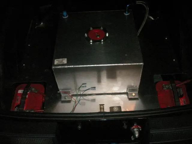

Alright,got some pics...

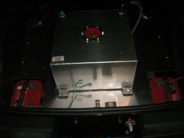

I would say its about 1/2 way done now,added the battery boxes tonight,now I got to figuer out the fuel cell mounting (got a 10 gallon instead of a 5 gallon,so a bit larger).I'll get more pics later,maybe when I get the wheelie bars mocked up or something.

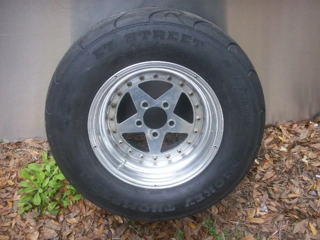

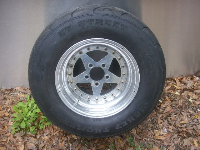

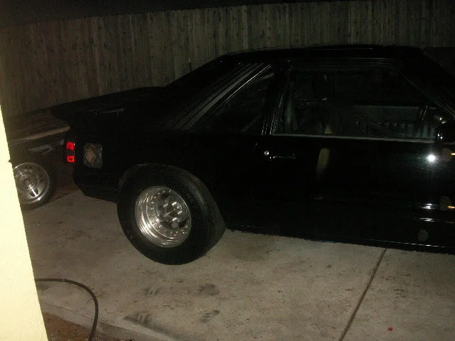

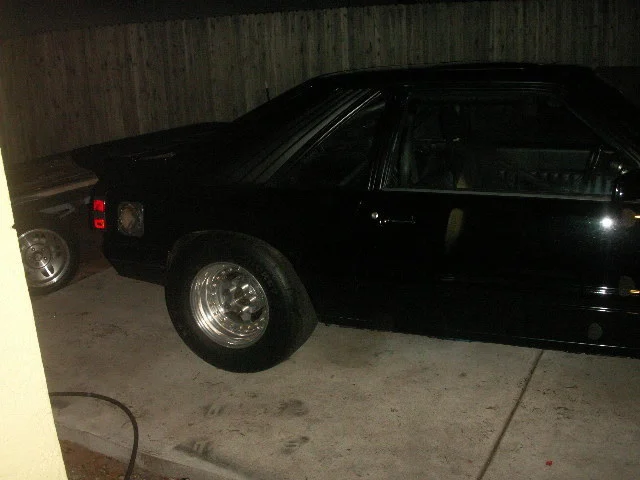

Oh,and you guys will piss yourselfs when you see the wheels and tires on car :D
they look freakin' awsome! :shock: (Holeshot 12" wheels with M/T 325/50 drag radials)

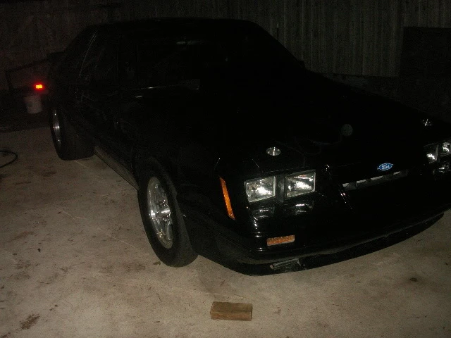

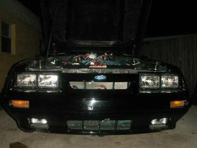

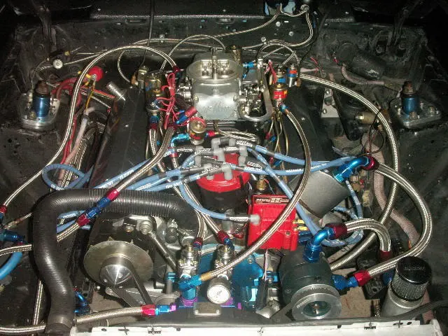

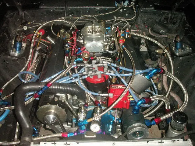

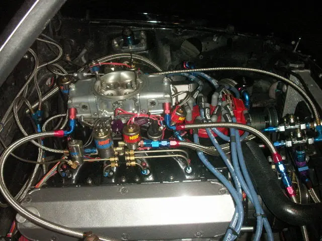

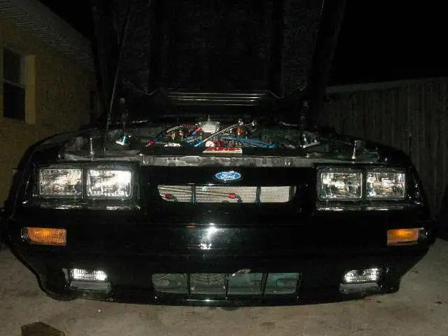

Not really much of an update,but some more pics,Ill get cage pics sometime.

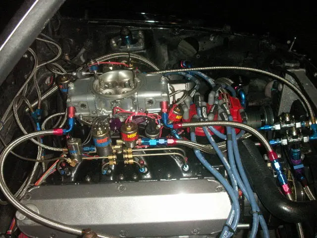

P.S. The lower intake looks great painted black.
Thank you,its my dads specialty.We had a powder coated black Jr. intake befor,and personaly I feel the paint has held up better,still glossy!
Its a shame I cant show you the block in a good pic,its dark silver metallic base coat/clear coat with an epoxy based primer (same as auto body really).Its all held up very well,actualy now that i think about it,I think the block is the same color as the valve covers (there painted to).
