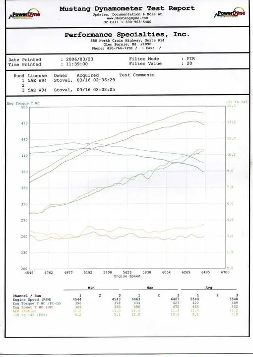

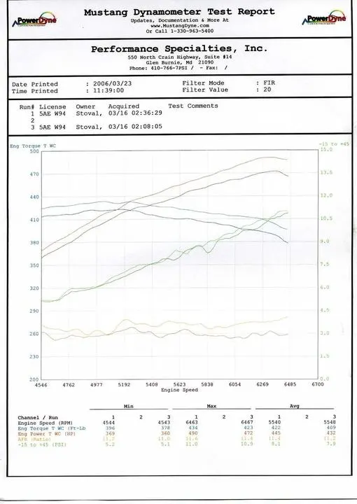

As requested by Thump-rrr, Here's the dyno sheet for my car

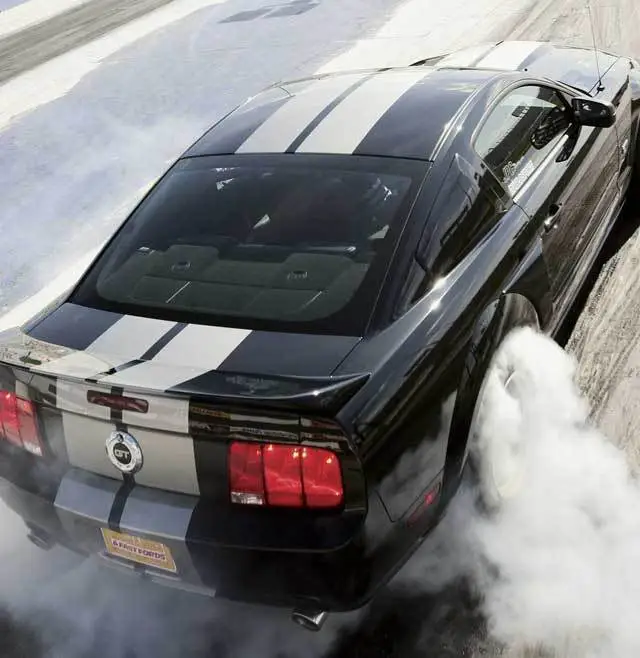

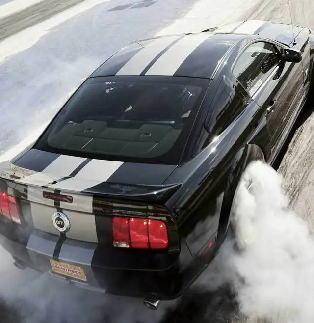

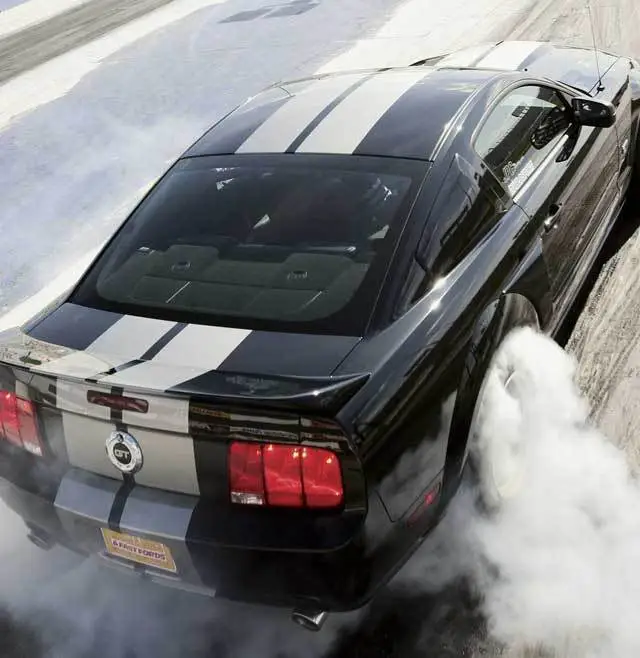

Oh, and here's a cool burnout shot I'd like to share
