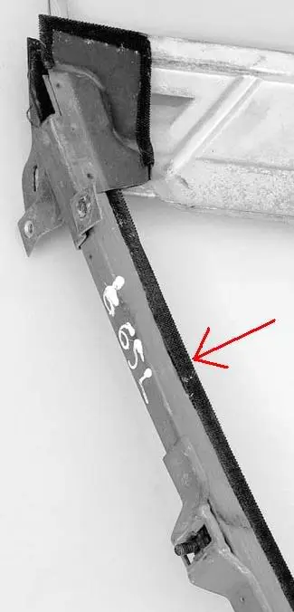

What's the material inside the Window Track?
Tim65GT said:
This web site says its burlap?!?!
http://www.mustangmonthly.com/howto/173_0306_wind/
Can it be purchases somewhere?
Is it hard to replace?
Apparently it was only 65-66 models that have it.
repops makes it and you could find it at california mustangs it cost about
39.00-49.00 bucks once you get it let me know so I could explain
the trick on how to install it.

Posted by Silver66FsBk:
repops makes it and you could find it at california mustangs it cost about 39.00-49.00 bucks once you get it let me know so I could explain
I dont know what repops is ... is that the name of the manufacturer?
Here is a link to CJ Pony Parts.
http://www.parts123.com/parts123/yb...~S1RF14171214771111521x~Z5Z5Z5~Z5Z5Z50000016A
They call it:
DOOR GLASS RUN WEATHERSTRIP
rear end of door glass
*Four feet of special cloth material
Thanks goes to Dennis112 :hail2:
I already bought and installed a like material and I'm going to give it a try.:rolleyes:
BUT, Just in case any one else is lookin':)
