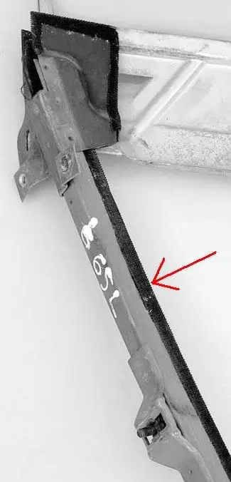

What's the material inside the Window Track?
Tim65GT
Feb 24, 2004
1,149
39
West Texas
This web site says its burlap?!?!
http://www.mustangmonthly.com/howto/173_0306_wind/
Can it be purchases somewhere?
Is it hard to replace?
Apparently it was only 65-66 models that have it.

I was thinking of just take the track with me to a fabric place here in town that stocks a crap load of auto type stuff and see if they have any.
Any one ever replaced this material or heard of it?
I had a heck of a time finding it. Tried all the Mustang parts vendors, paint/body supply shops, glass shops, etc. I finally found it at a vintage FOrd truck supply shop. It is called "Bulk glass tape"
EDIT - Nevermind. I was thinking it was something else (pic didn't load the first time). Isn't the stuff in the pic called moleskin? I got mine from NPD
I never found it for my '66. I just went to my upholsterer and had him pick some "stuff" that would work. It is a bit softer than the original but he says he has used it before and has worked good. It looks like a soft but heavy burlap but it is not burlap. He installed it and it is doing dreat.

I bought the material today for the window track. They didn't have the exact type stuff, so I got 2" wide velcro... just the loop part, not the hook part. I scraped all the old crap out, what was left of it that is...
Then glued in the velcro. I'll post pics later when I get it together and see how it works.

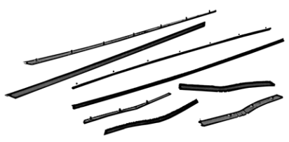

i thought moleskin was what they used on the window channels to keep the glass from rattle around when the window is up/down and to keep water/crap out of the inside of the door.
