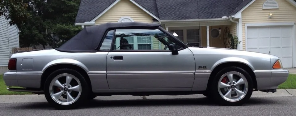

Looking to purchase lowering springs for my 91 vert because I think it sits too high. I bought the car a little over 2 years ago and the suspension is about the only I haven't replaced or repaired at this point. I can't tell if it has the stock springs or not. I don't want to purchase new springs if it's not going to do anything for me.
Picture attached for reference. I'm running 17" wheels on 245/45/17 tires.

That looks stock to me

Me too but I always like to get a second opinion when I can.

For reference here's my 93 on 15s. Same tire to fender height.

Looks stock to me. Word of caution- lower is not better. You really do not want to lower the car more than 1-1.5 inches or you start messing with suspension geometry, handling, and ride. Also, if you lower it over an inch you will most likely need CC plates. For what it's worth I would look at either H&R or Steeda Sport Springs . People have also used Bullit or Mach 1 springs- they will not lower the car as much but are factory OEM qualiy and give a firm ride.
Just saw the kit you ordered. Those are decent springs as well. A little pricey though.
