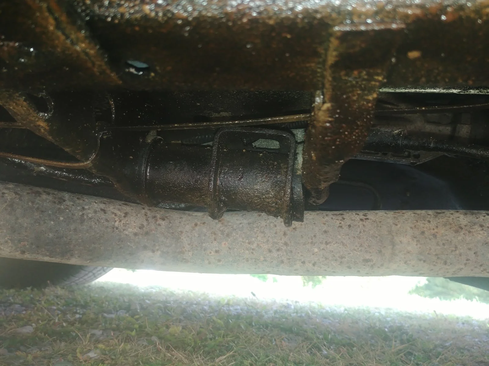

Whats this? Next to the torque box. Looks like 2 replaceable pieces

Looks like trans crossmember to me too.

Well, yeah... major priority. Without it, your transmission is hanging off of the back of the bellhousing, torqing the engine that direction, and throwing your U-joints outside of the angle they're supposed to operate within. This can lead to vibrations, u-joint failures, and tear up the seals on both sides of the driveshaft & engine mounts. Plus, probably more secondary effects.

Yeah, just get the car up on jack stands, support the back of the tranny with the jack. Unbolt and pull off the cross-member, and do whatever you need to, before reinstalling.
Keep in mind that brand new replacements come as “adjustable”. Meaning you need to weld those tubes to the crossmember once you have the fit correct. Or you could go with a Stifflers for a little more money, and skip the welding.

Very funny. It was just a general description of the location. Anyway thanks for the tips on the need to weld certain new crossmembers. Probably would go with the stiffler then as my welding skills arent really skills.
