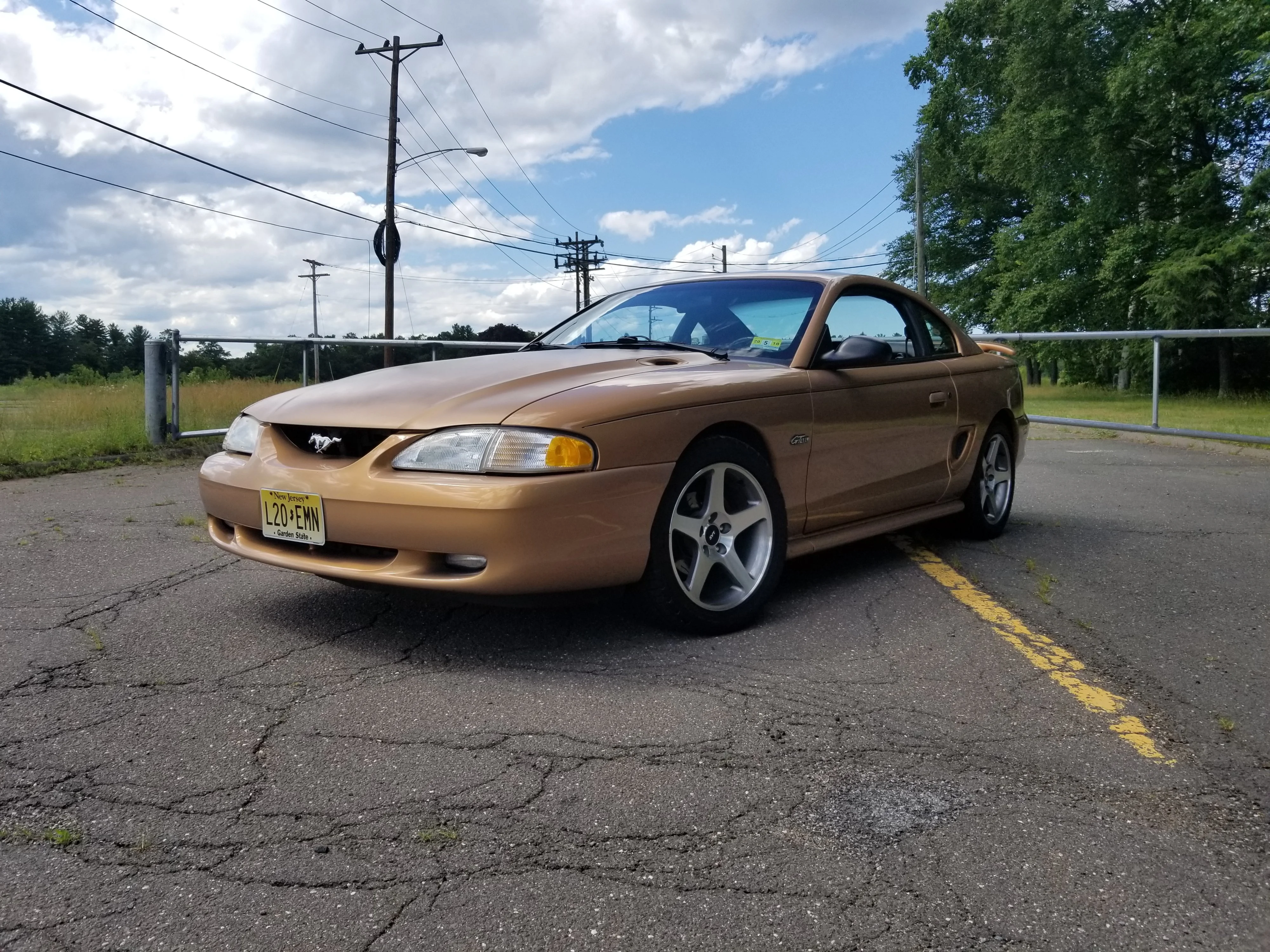

Oh, did you post pics of the car? If not then we will email you a bill. :jester:
Reactions: BlakeusMaximus
No haha here ya go..
