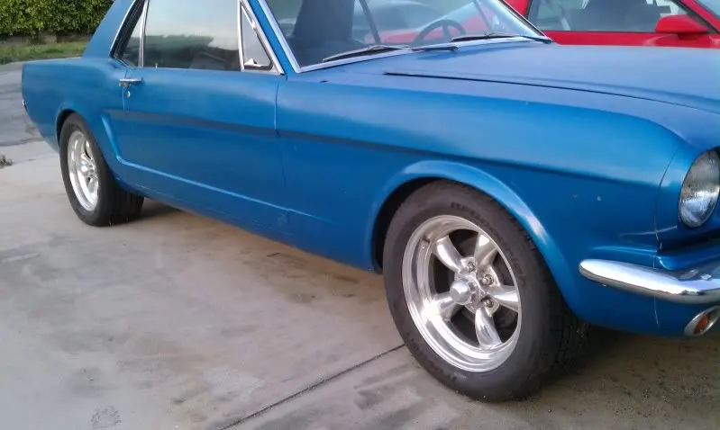

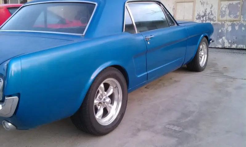

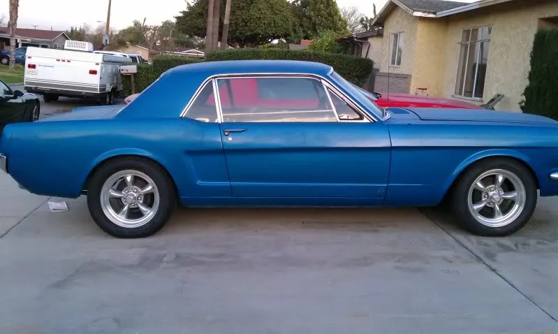

The fronts are 225/50/16 and 245/50/16 on the rear.The front has 1" lowered springs and the rear are stock sagging leafs.
Reactions: That65owner
The wheels and tires on that blue coupe look great. Are they 16x7 or 16x8?
I wouldn't go 205 on an 8 inch wheel, I think that will make the tire bulge out at the side wall.
