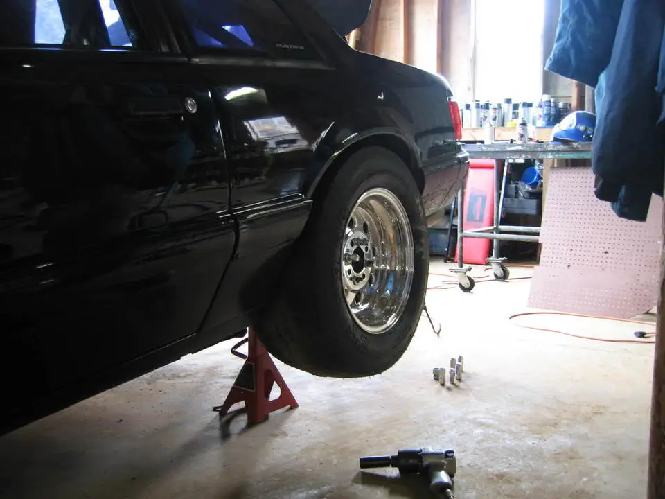

btw: i found a post while doing a search from user name "DNA DOA" on this forum, this guy has 15X9 draglite with 5.5 backspacing heres the picture
i want mine to look like this. and i was wondering if 6inch backspacing is correct or 5.5bs on 15X9 weld draglite.
