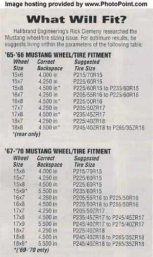

L lauras70mach1 Member Aug 1, 2004 202 0 17 minnesota Nov 20, 2004 #1 Nov 20, 2004 #1 Someone posted a chart for different wheel sizes and spacing a while back. Can whoever that was re-post the link? I know, shoulda bookmarked it. TIA

DarkBuddha Founding Member Dec 11, 2001 2,215 1 47 Seattle & Tampa Nov 20, 2004 #4 Nov 20, 2004 #4 In addition to Dodgestang's chart, there was one posted in one of the big Mustang magazines... here is a scan that I picked up somewhere... Attachments Wheel and tire size chart.webp 33.7 KB · Views: 9,046
L lauras70mach1 Member Aug 1, 2004 202 0 17 minnesota Nov 21, 2004 #5 Nov 21, 2004 #5 This is exaclty what I was looking for. Thanks for your patience, guys.
