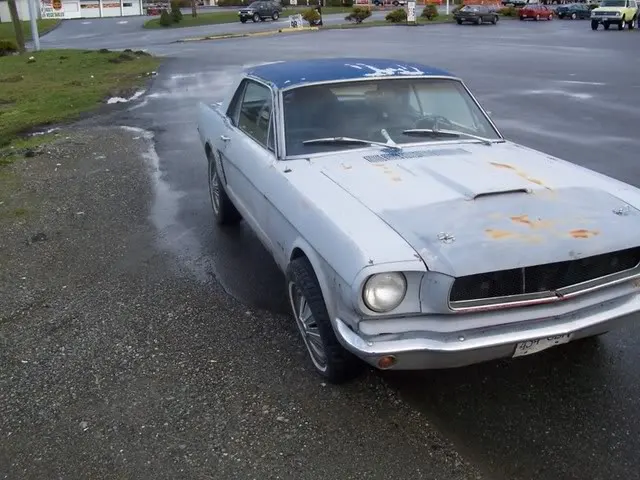

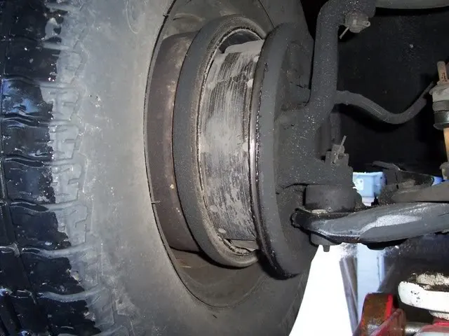

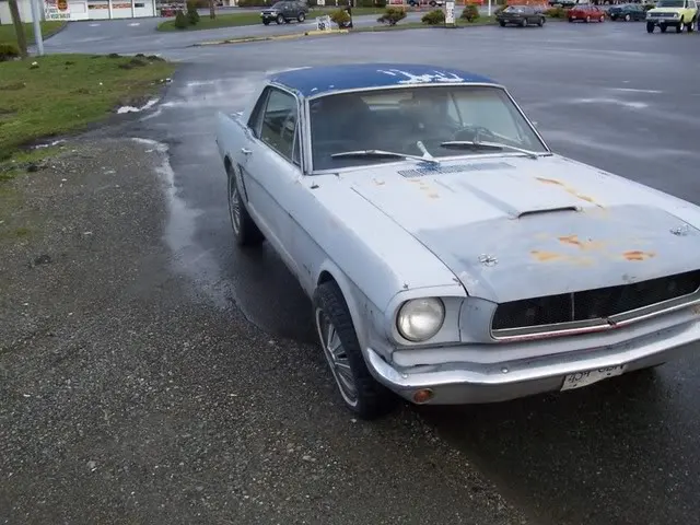

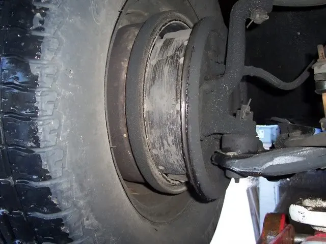

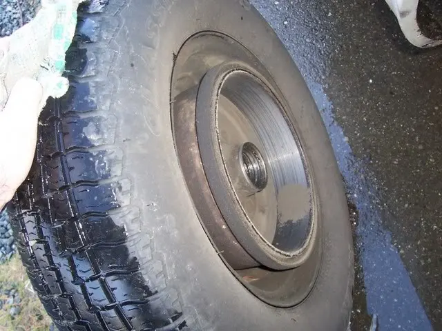

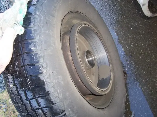

Wheel came off while driving! Not good!
I heard a small "POP!" followed by metal on metal. I was able to crawl on the shoulder the half a block to the gas station so I could get off the highway.
Although I knew it was the wheel bearing, I was shocked to see the extent of the damage when I got home and the fact that with the single bowl master cylinder I completely lost my brakes when the drum pulled off while the car was moving.
I lifted the car on the jack and without removing the lug nuts pulled the wheel off drum and all. The wheel was just hanging on there and if I hadn't got to the side of the road as quick as I did, the day could have been much worse for my son and I.
The nut, cage nut, and cotter pin are still on the spindle (superheated of course), but the outer bearing and fender washer have now been transported to another piece of spacetime. I am suspicious if the washer was even there to begin with.
Funny thing is, only two days prior to this I had jacked the car up and checked all four wheels for bearing play and ease of rotation and there was no indication that there was any problem with this one.
Fortunately I was able to get another V8 spindle and drum assembly before I even got the car home.
