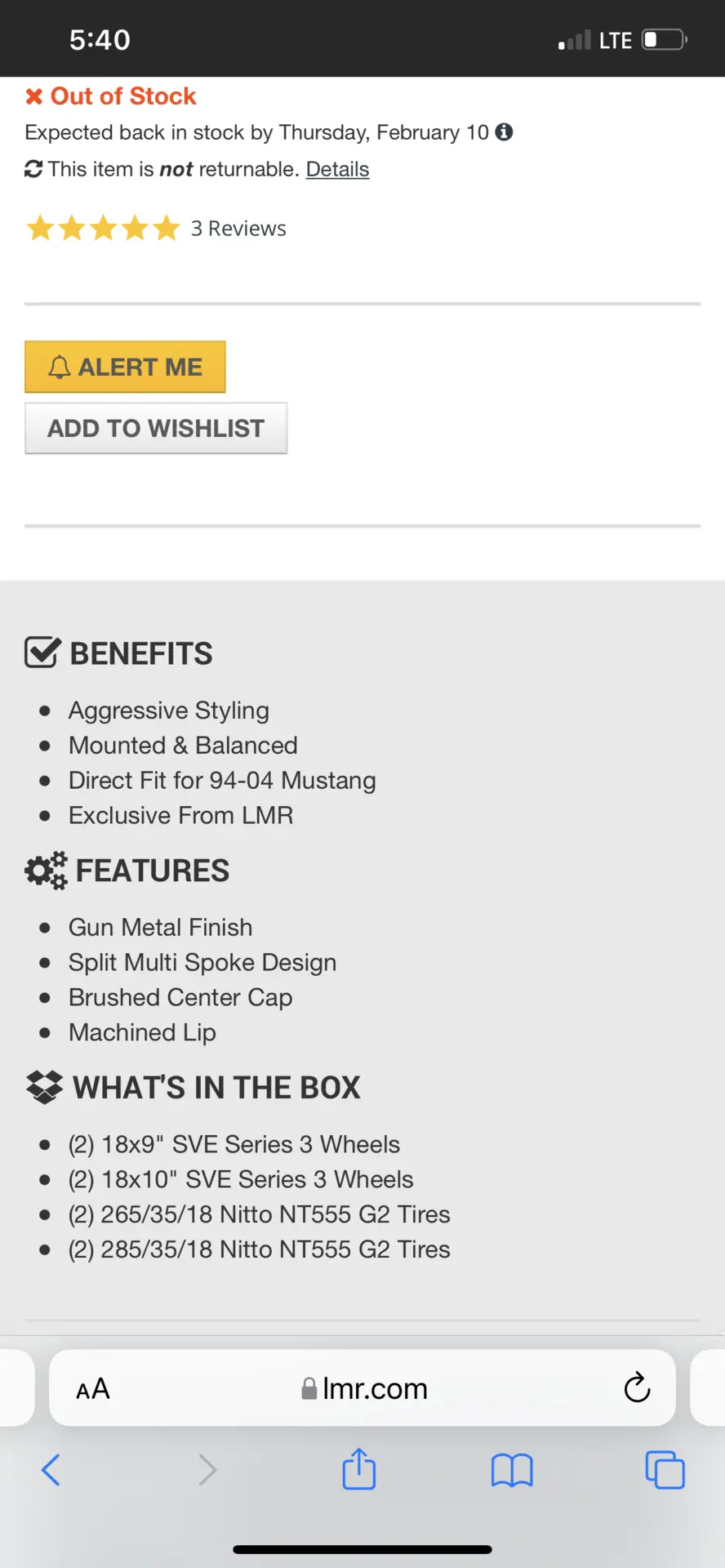

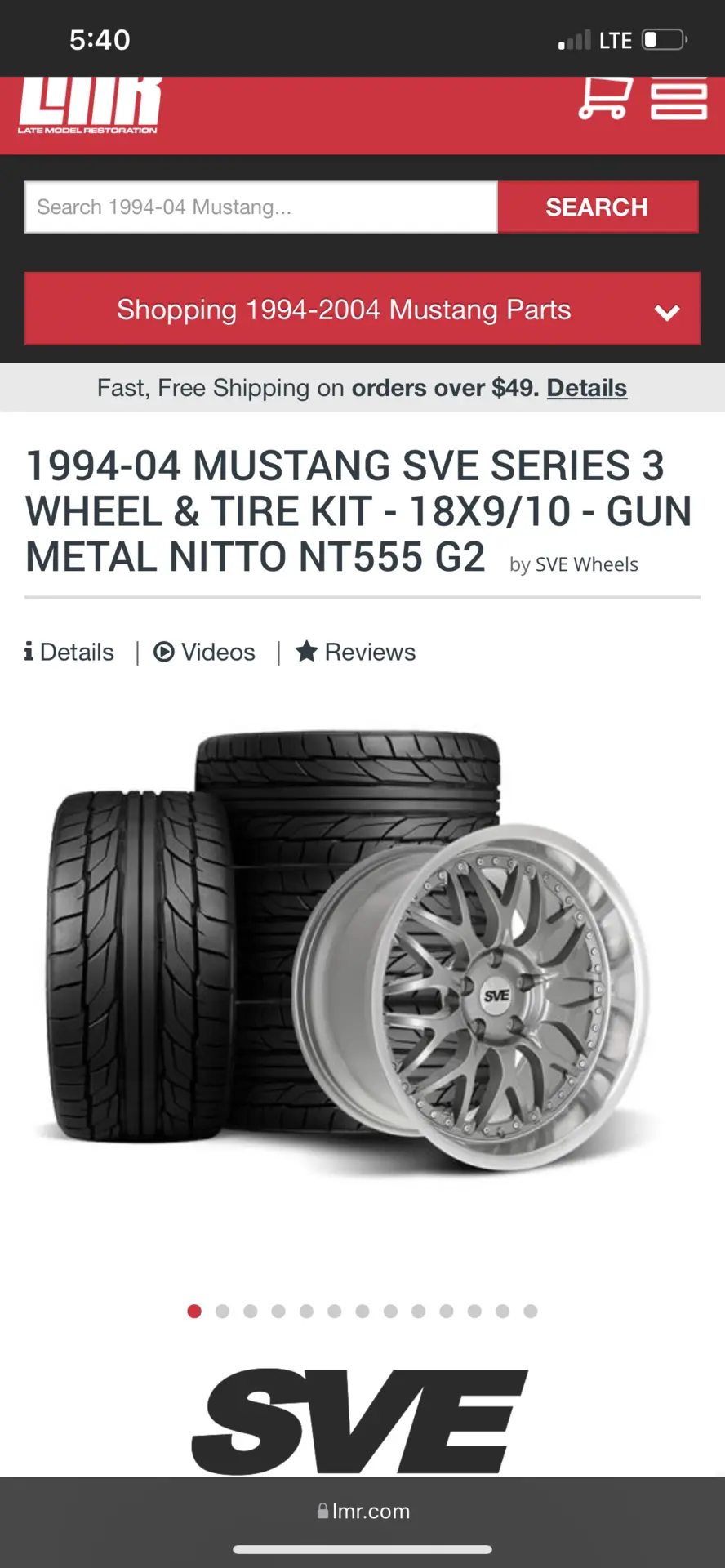

Will this wheel and tire package fit on my 88lx? It has sn95 spindles with a team z k member and coilovers. The rearend is fox length with no quad shocks. Can’t return them and just want to be sure. Thanks!

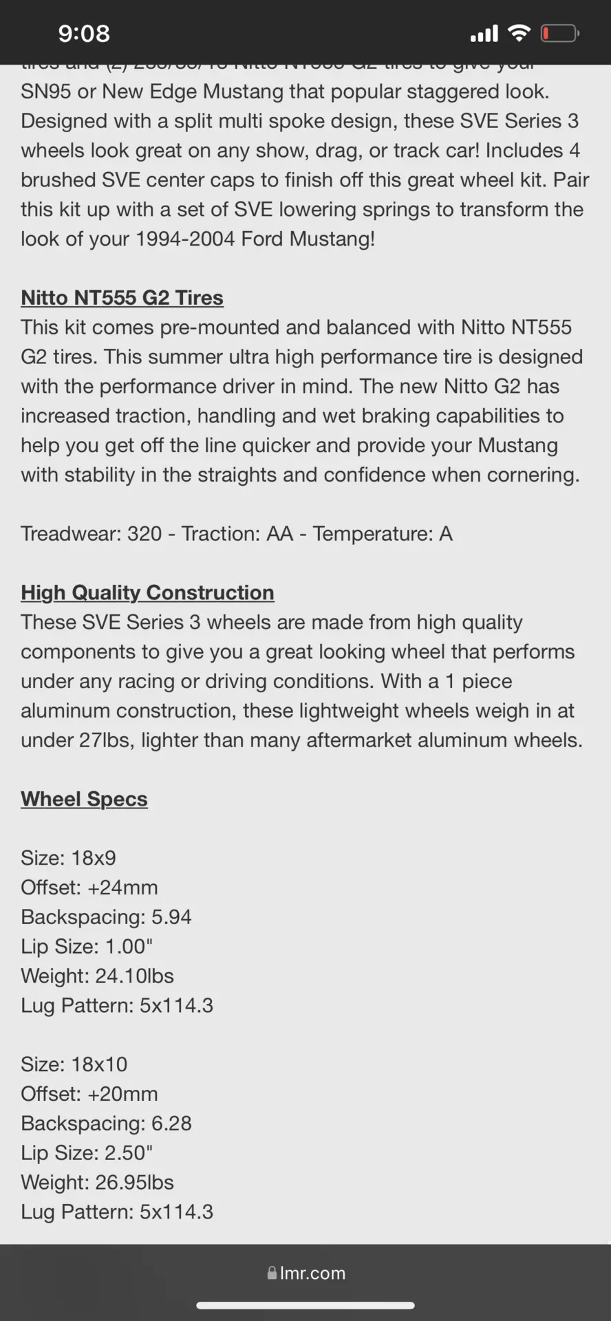

Offset/backspacing info is critical here. I have 18x9 all around with +24mm offset. I needed a 5/16" spacer to keep my rim from rubbing my coil over coil.
I have 255/35/18 front tires and because they are shorter than stock and the spacer I don't get a rub on fender or inner fender. In the rear I have 275/35/18 on the 18x9 rims. The next tires for the rear will be 285 or 295 in width. I have fox length axles and the same 5/16" spacer (because it helps the rear look better) and I believe both the wider tires will fit without issue.

This is the rest of the info on this set. I don’t really know anything about backspacing and offset. I just really like the way they looked. I can roll the fenders if I need to also.

On a 10in rear you really want 6.5in bs for a fox.

I would guess you will probably need spacers, not just for clearance but also to make them look good. I have 17x9/10 on mine with similar offsets. The rear sat so far inside the fender it looked terrible, needed a half inch spacer to push the wheel out to the fender. Front wheels hit the coils overs, needed a half inch spacer up front for clearance, may not have this issue with springs. Math is hard but that's what you'll need to do to get your answer. Or you'll find out when you put them on, like me.

I appreciate the feedback. I might just buy from somewhere that will take returns on wheels and tires and just go by trial and error. Gonna try to get the math right so I don’t have to use spacers. Should be lots of options for 5 lug. I just like the way these sve wheels looked.

I know you have a lot of info to wade through from the previous replies. With that said, the simple answer to your question is yes, they will fit. You will need to roll your fenders. I didn't get their tires (got a killer deal on some new Michelin Pilot Sport A/S's instead), but have the same rims for my '92 hatch.
