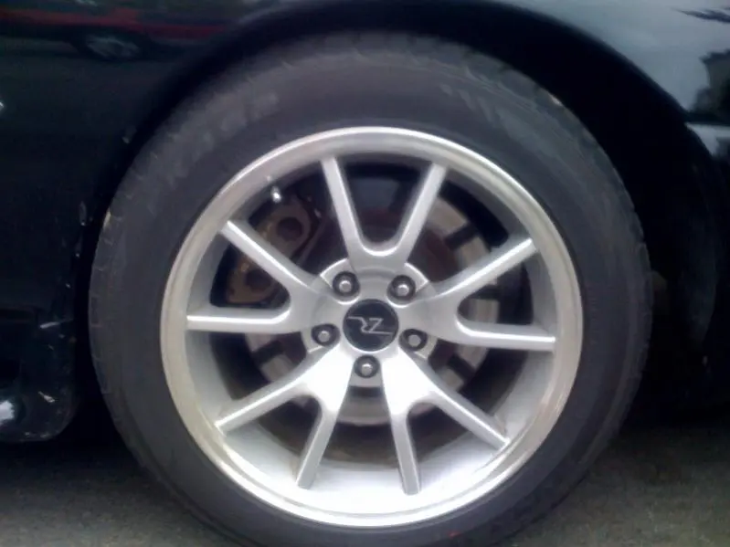

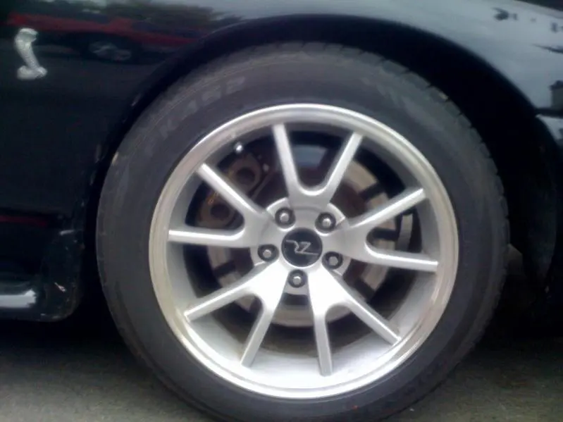

The front wheels on my 95 Cobra are too far back. Attached is a picture with the wheels straight ahead. Same on both sides. Any ideas? I'm thinking MM coil overs with the forward offset control arms may do the trick ( I want to get coil overs any ways). But what could be the real problem here?
Car's front suspension has tokico shocks, HRSS springs, MM CC plates, and a brand new steering rack.

I dont know how or why your k-member would be back so far, and Im not sure that factory mounting points would put it there... I dont how else both sides could be back that far though... Does your engine sit back really tight against the firewall?
My car is the same way....

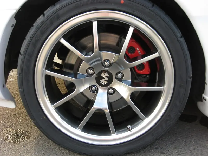

Heh, you have the exact same wheel setup as me. I even have the same before after picture with the new fat tires sitting next to the old skinny ones. Love the FR500's.

Someone would probably have to have an "offset" wheel's Stang next to a "normal" Stang to see what's different. If the K-Member is twisted somehow you wouldn't be able to see the difference easily in the engine bay, unless you were able to compare engine bays.
I wonder if one of the control arm mounting holes is off? Or could the front clip be tweaked slightly from the factory? My black 'Stang's wheels are centered but the driver's side sticks out about a half-inch too far, it's noticeable compared to the other wheel. :shrug:
It might be a tolerance stack issue from the factory. I do believe that the stock k-member is slotted at its chassis attachment points. You may have some wiggle room to slide the entire k-member forward to center it a bit more. What condition are you’re front control arm bushing in?
Go get the car aligned. The caster reading will tell you if there is a problem. You could also measure the distance from wheel base on each side (measure center to center). The numbers should be within .5 in of eachother. But the alignment would be the best bet to see if there is a problem as it measures quite a few different angles.
