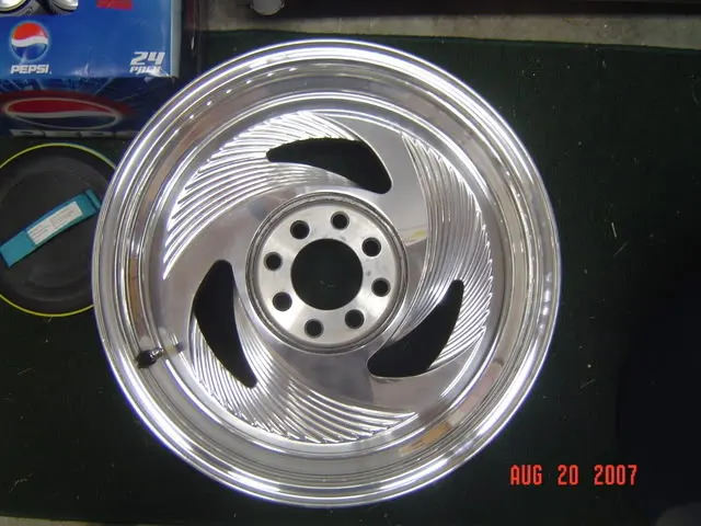

About 2 weeks ago I put the Weld Aluminum wheels back on the Pony. Took a trip yesterday and got a lot of vibration when I went over 55, I could stand it at 61, but on the Interstate, 72 was pretty rough. I stopped at the Tire shop that I bought my tires at and they rebalanced them, but it was still no good. They said my wheels were out of round like from hitting a pothole, etc. They had some hop in them.
I put the 10 holes back on with the 215/60's and all is smooth again. I don't know what to do. I liked the new wheels, but I am thinking they were too "blingy" or shiny for my Pony.
I am also out the $400 I spent on them, but can't really honestly sell them with this problem. Maybe I can sell them for aluminum scrap
I am thinking seriously of getting pony's for it in the future and reuse the 16" tires, but not sure of anything yet.
Has anyone heard of a machine that puts roadforce on the wheels so that they can be balanced?

If the wheels are out of round, no amount of balancing is going to help. They can be repaired, but it will probably cost you more than you paid for the wheels.
Metalcop
Jun 6, 2004
148
28
New Hampshire
Apr 10, 2008
  • Apr 10, 2008
Having the wheels repaired, meaning straightened only, will cost you in the neighborhood of $100+ for each wheel. Probably just one of the front wheels is bent, but they should both be checked. What size Welds are you running? If you are running 'littles' up front, then you just gave the perfect example of why these wheels have no business being run on the street. Not even factoring in how unsafe these wheels are for panic stopping and turning...

I called the place that balanced them 2 weeks ago and asked them if they had a road force machine. They said they did. I asked them why they didn't use it and they said did you ask for it. I said no, I told them I didn't even know it existed until 2 days ago. Kinda hard to ask for something if you don't know it exists So I am taking the wheels/tires back by there this afternoon and see what they say. I'm thinking that when they balanced them they should have known something wasn't quite right. I'm giving them one more chance to make it right. Getting kind of old haulin them over there and then putting them back on car to check. This will probably be the last time I try them again.
No skinnies, just these. I am still not for sure it may be the tires, but can't wait to see what this shop says is wrong with them. They shouldn't charge me a dime since I paid for balancing not too long ago.
glowstang93
20+ Year Stangneter
Feb 9, 2003
853
39
Illinois
Apr 10, 2008
  • Apr 10, 2008
Just got the wheels back on, took me 25 minutes this time. I think I may have to try out for a pit crew Took it out for a test drive. Slow speeds don't seem to have the hop that it had before. Got it up to 72 (in a 55 ) and it seemed to be a lot smoother. The shop used the Hunter GSP9700 RoadForce Machine. It's like a $17,000 machine that the owner said they don't use unless the customer asks them to use it. It does cost more than a regular balance. Ended up costing me $64; initial balance and roadforce together.
The machine puts a load on the tire and then tells the tech which way to turn the tire on the wheel to balance the highs of the tire with the lows of the wheel, making it truer.
Only time will tell, but I'm hoping it will stay good for a while.
