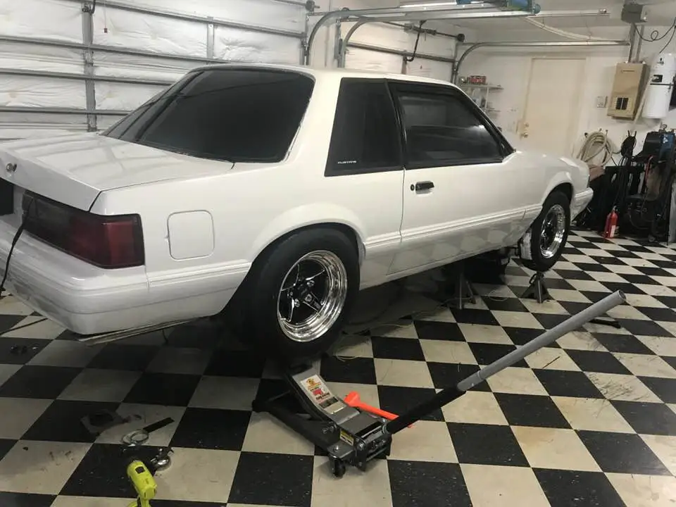

Hey everyone I am new to the group im hoping someone can help me, possibly someone has been through the same situation. I purchased a five lug conversion kit from LMR.com https://lmr.com/item/SVE-2320SVO-K/1987-1993-Mustang-5-Lug-Front-Brake-Upgrade-Kit. I also ordered and installed a Moser 9in muscle pack stock length rear, my question is what rims can I use with this set up? I did not notice until after everything was complete that they had a kit to use SN95 spindles. Will 96-04 rims work on this car? If anyone has any picks and links to rims that they have used with this set up it would be greatly appreciated. I would prefer an 18" rim. https://lmr.com/item/WK-1007FG/mustang-sve-drift-wheel-kit-18x9-10-gloss-black-94-04 will these work?

LMR really shouldn't sell that kit that includes the 73mm calipers as an "upgrade". There is no proper MC for that Caliper/drum setup and it throws the bias way off. Even MM doesn't recommend that setup.
With that said, the same typical issues with center cap fitment are present due to the SVO style rotors used. You may need a spacer to get the center cap on.
As for the SVE drifts, I'd ask LMR if they will clear the caps on the rotors. For the most part a lot of the 96+ sn95 wheels will have fit issues up front. Spacers push the wheel out which widens the turn arc which can create rub issues when turning
