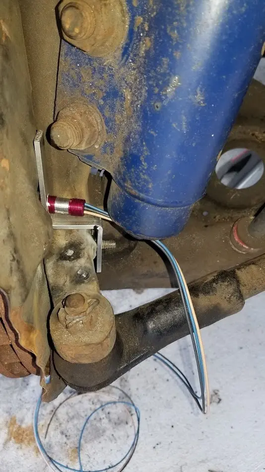

This is the hall effect sensor thats recommended, but I'm not sure how it would work with my spindle and hub.
This is the same sensor I use to watch the back of the front wheel studs for traction control. The factory sensor is likely a 2 wire vr sensor, to use it you will need a vr conditioning circuit. What ECU are you using and what inputs do you have open?

Does the sensor pick up the heads of the studs?
Yes it does I treat it like a 4 tooth wheel.

this was from a few months ago during mock up, I welded the stud onto the arm.
