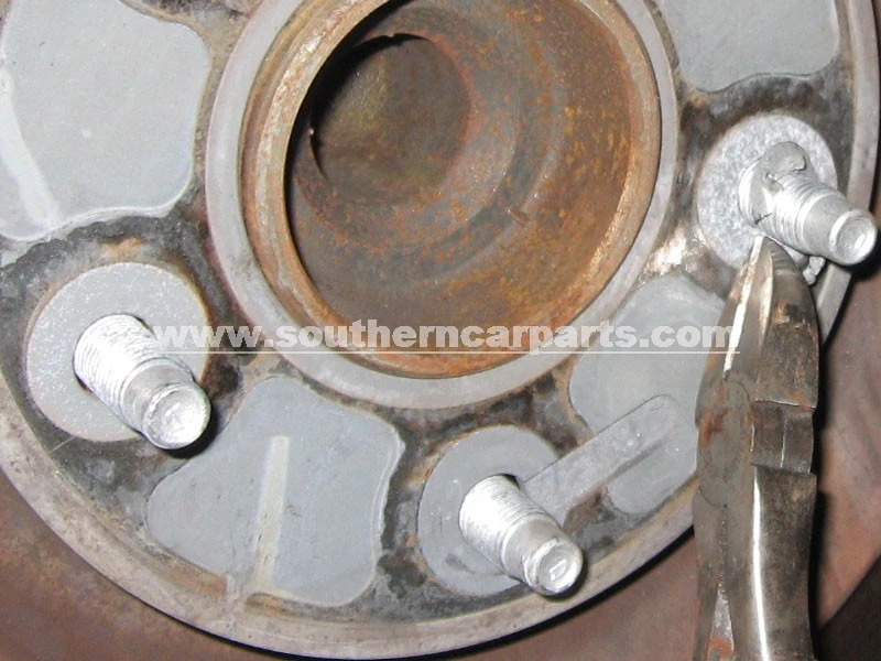

Out of curiosity, are the washer things that they put on the studs still on there? I only ask cause I have a buddy that put some wheel spacers on his Dakota over those and it caused a bad vibration.
Interestingly enough, they didn't come with washers. That's interesting.
You did remove the rotor retaining tabs (I believe that's what Notch was referring to...)?
This is going to sound really stupid, but I don't remember seeing the tabs. I'm going to have to take the wheels off and inspect. If the tabs are there, I should remove correct? Thanks for all of your help btw.

The tabs may not be there if the rotors have ever been replaced on the car. Generally speaking they were installed on the assembly line to retain the rotors before the assembly of the brakes and installation of the road wheels.
If the tabs are there definitely remove them before installing the spacers...
