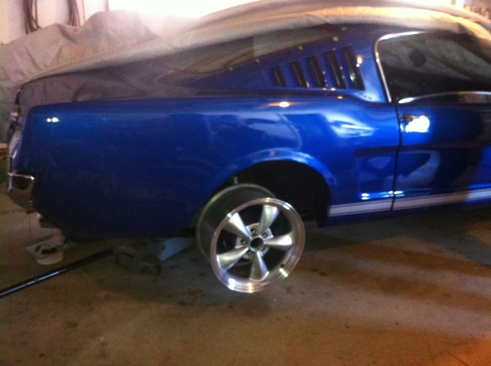

image.webp Hi does anyone know what size spacers to use when installing 2004 bullit rims? I've read you need 1inch on the fronts and 1 on the back or is it 1/2 on the back? For my 65 fastback thanks
its my understanding that you need a one inch adapter on all four corners. an adapter is different than a spacer in that the adapter bolts to the hub, and the wheel bolts to the adapter. which is what you want by the way.
