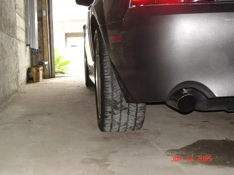

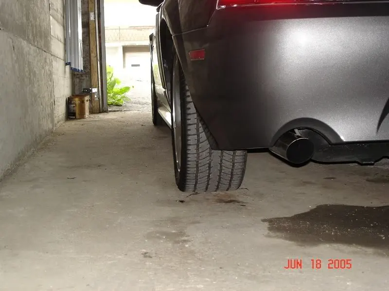

bokinsmowl said:
anyone have before and after pictures? please write what size spacers they are...thanks.
H&R 1 inch
BEFORE:
AFTER:
