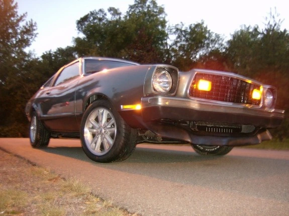

17" x 7's
i think the 7" wide rim is as far as it will accept in the front at least my fronts do not rub at all they have 225/50/17's on all four corners (buddy went to 18's on his camaro so he sold me these 17's (tires only) for 40 buxs already had the rims ....OK i have tryed to upload photos of my 17's i cannot figure it out HELP PLEASE
