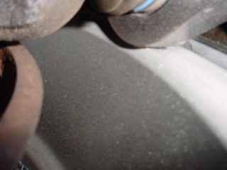

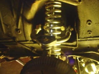

Well, I thought I was in the clear but the wheel touches the UCA. With a 5/16" spacer it's OK and doesn't touch, but then my inner wheel weight touches the UCA. The first pic is before the spacer, this is on a 17x8 with 4.75bs and a Unique Performance coilover. It has a pretty hefty lip on the UCA.
Question is, what would you do - I don't know enough about wheel weighting and balancing to know if I can go ask for a different style weight from the tire guys. Or should I leave it as is and file down the UCA? It would require quite a bit of filing and I would rather find a different wheel weight - they used flat ones on the inside of the alloy wheels opposite to these, why not a flat one on this side? :shrug:

I have an opinion which may not be appreciated. Get new Wheels with the correct backspacing.
I'd never grind on any suspension part as that's asking for catastrophic failure which could injure or kill you and others. I'd maybe try to find a 3/8 spacer but that's about as much as I'd go and I don't know if that's enough.
I have seen internal weights but I don't know if that's an option or not either. These weights look like the chiclet style gum and are glued to the area behind the spokes. The flat (are like the ones I mentioned) ones you see might come from the factory to balance the wheel, but the addition of the tire changes the balance.
the flat stick on weights can replace those, thats all ive ever used on all my wheels. in addition id look to do some slight grinding to the UCA to try to get u down to a smaller spacer. im assuming ur running standard length studs?

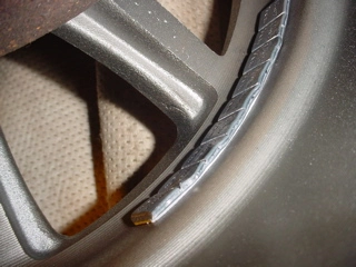

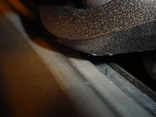

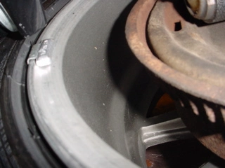

thanks for the comments Reen, I don't plan on dying in a spectacular fashion anytime soon. :D Here are some better photos not taken at midnight. They are flat wheel weights on the other side of the same wheel inside the rim, and the tire weight is on the opposite inside corner of the wheel.

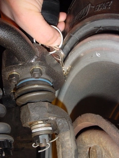

Also, better photos of the UCA clearance otherwise. 2 Mustang car keys' worth at the closest. That's with the 5/16" wheel spacer - 2 shops have told me that should be OK but I can go down to 1/4" if I solve this weights issue. Yes, they are standard wheel studs.
Thought I was in the clear, literally. I never thought about those little lead weights. :nonono:

tire is in the clear

no, the tire will be fine - you can kind of see that in the "keys" photo. The only thing in the same plane as the tire is the grease fitting, and that's way in there.
i'm sure i'll get flamed for this but, i would seriously consider doing some grinding on that UCA, grind it down so have enough clearance and then have a piece welded back in. the structure is just fine and it won't hurt to grind on it, it is just the design of the ball joint cup, it sucks. that's one reason i don't like the UP coilovers, everyone else uses a flat plate to mount the ball joint except UP.
check some of opentrackers posts about modiying the stock UCA and you'll get an idea of how to modify these. personally i'd feel safer modifying the UCA than using the spacer.

Hi, if those pictures all came from the same tire, it looks like there is 2.25 oz of "stick-on" weight and 1/2 oz of rim weight.
If that is all in the same spot, I'd break the bead and spin the tire 180 degrees on the rim and re-balance. might find you can get away with a lot less weight that way.

Yes, the photos are all on the same wheel/tire. It's not in the same spot, they are diagonally opposed across the wheel - the "stick-on" is toward the outside of the rim and the rim weight is 180 degrees opposed on the inside of the rim.
It looks like the consensus is "go to a high-end rim/wheel shop and get wheel weights all around rather than rim weights and wheel weights on the same wheel" I'll just peel up the rim weights and drive slowly to a good shop.
As far as the spacers go, I can figure that out later. UP has an external ridge or wall that the A arms themselves are welded to, rather than a flat plate as bnickel points out. My concern about filing the lip is that if that ring is the main thing that supports it rather than the flat plate, I'm thinning it out at its' thinnest point. Bad photo attached.
Yeah, bad design of that cup bnickel. Oh, I see what you're recommending, an internal reinforcement/gusset to make up for what is taken off from the outside.
