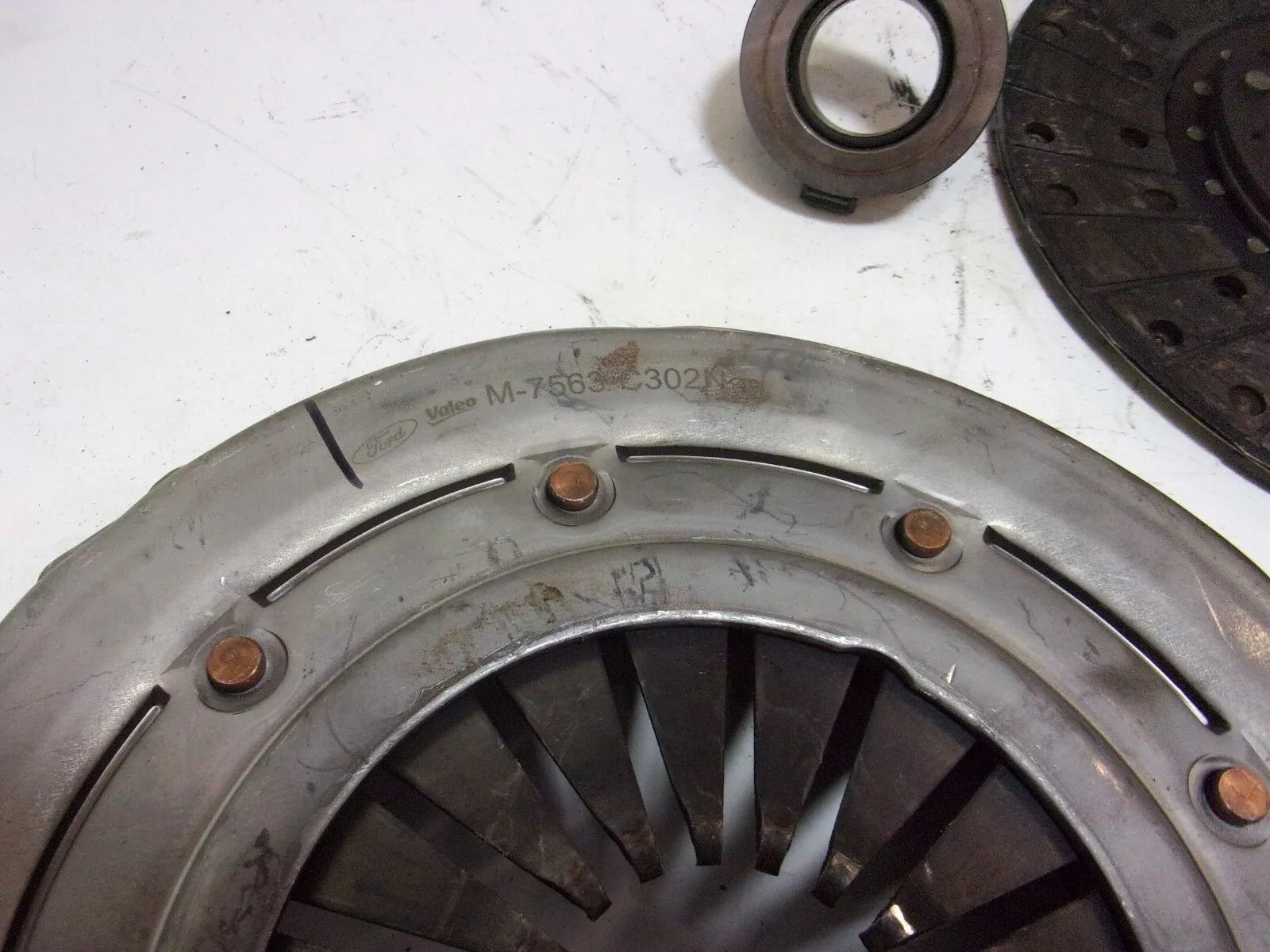

This is what the last frpp branded king cobra I bought looked like, branded both ford and valeo but it was a long time ago from downs ford when they where vending at a local event, came in ford racing box. Valeo changed there part number system and have updated some pressure plate designs since then, its also been a while since I peiced together a clutch using that pressure plate. Most advertising a "king cobra" these days are selling a generic disc packaged with a valeo FDC-09 pressure plate, valeo has 3 pre packaged signiture clutch kits and sell all the parts in bulk to retailers who peice them together cheaper. part# 62672006, 15% clamp load, 62672005, +20% clamp load 62672004 the "Hd" 20% clamp load with a "heavy pedal". The 62672006 would be the closest to the old ford racing king cobra kit but its also impossible to find. Best bet would be to contact one of the well known transmission shops like Hanlon or D&D and ask what they recommend these days.

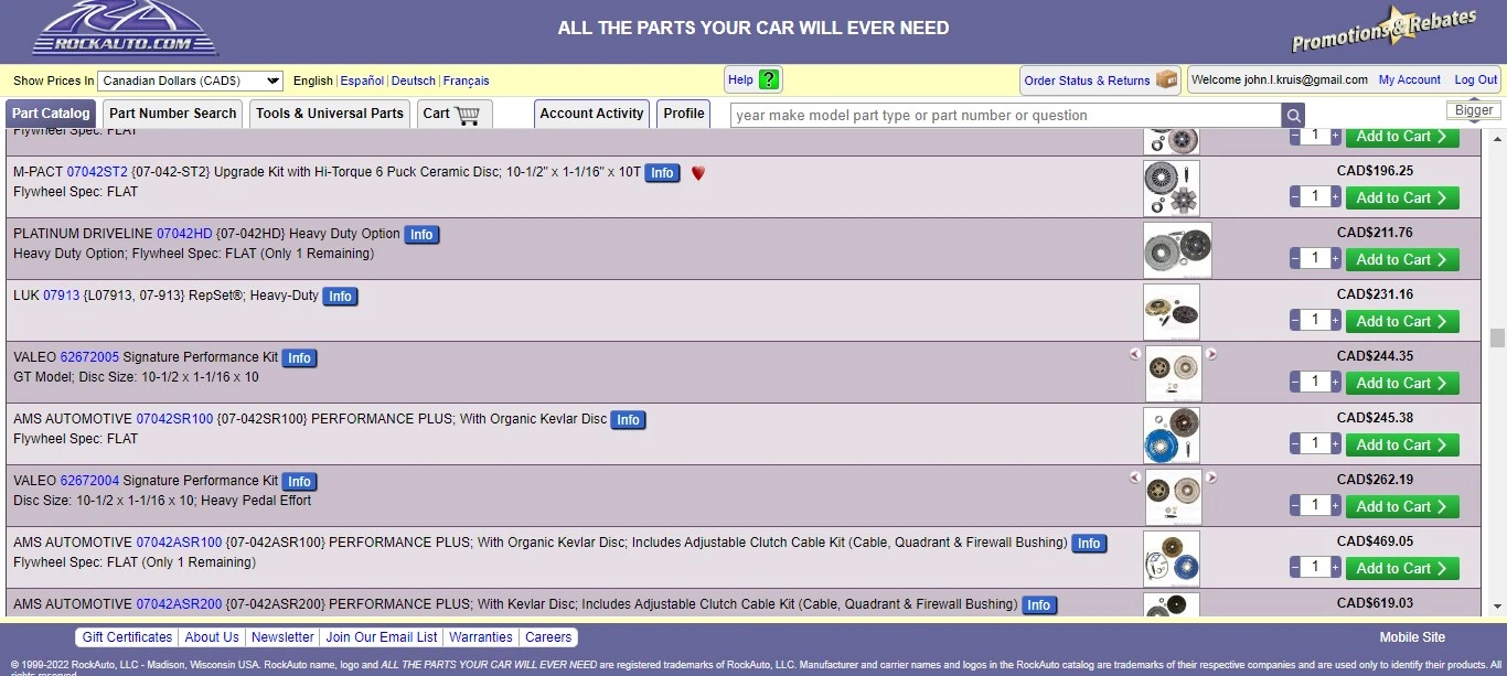

Listed as a 52672006, but probably the same thing.
The other two:
I know the prices are in CDN but they work out to $189 USD for the 2005 and $202 USD for the 2004 unit.
That's the oem replacement line, the pressure plate might be these days though, but the disc and bearing aren't. Been ages since I bought one. Valeo also has a d/f centrifugal "pro line" clutch that starts with 700 part number or at last they did, was stupid expensive back then. If you look at the promotion one on eBay you will see the orig king cobra design with the stamped fingers to control the clamp force of the Fdc41n pressure plate which was a lot lighter then the HD plate, all the real cheap generic ones I've seen have the fdc09 plate or a LUK pressure plate and a chinese friction disc.

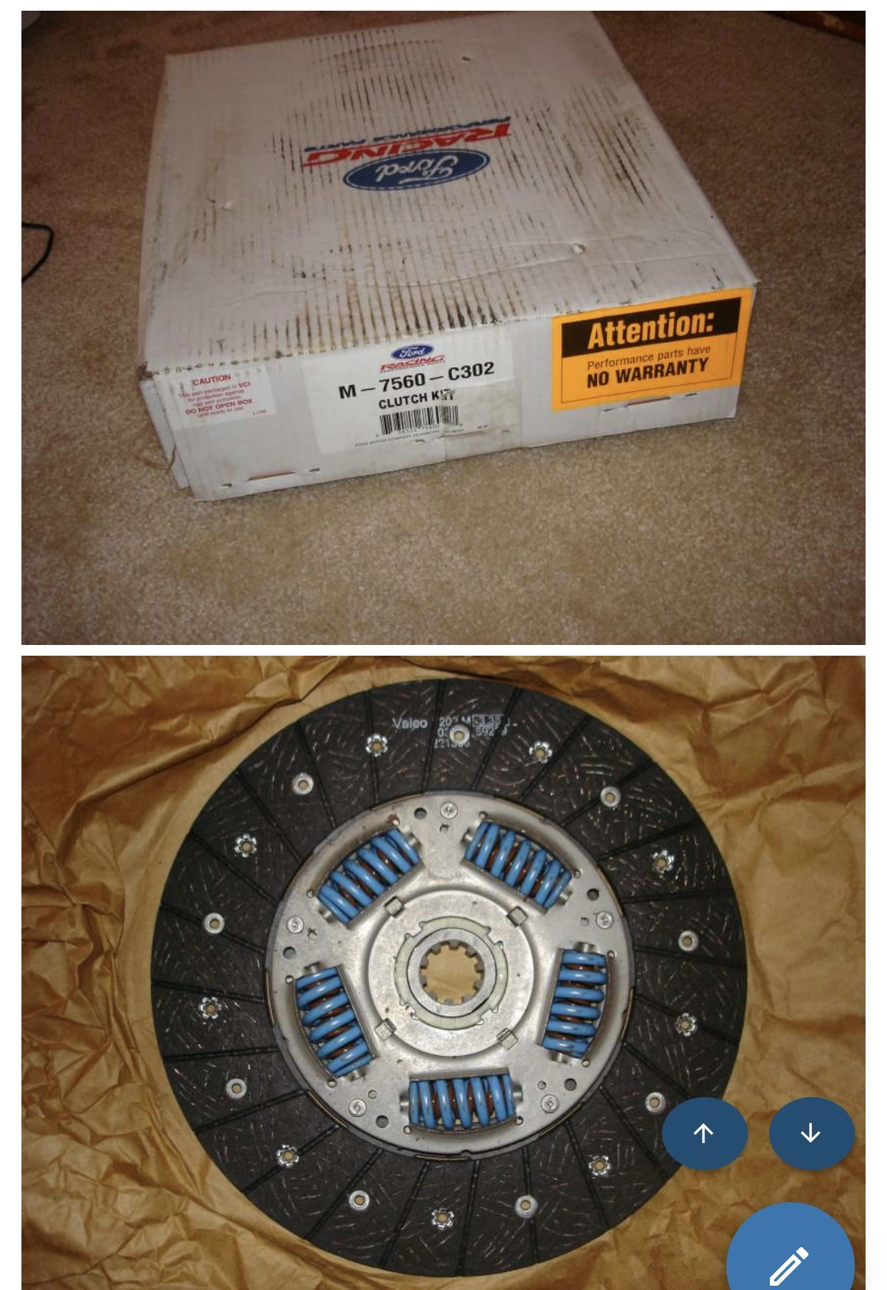

They made a few versions of the old KC kit. Depending on the pressure plate and disks they had different pedal effort and different holding power.
I have the M-7560-C302 kit which I bought back in 2008 and is the reduced pedal effort version. The pressure plate and clutch disk are made by Valeo. The throwout bearing was Ford which is still available separately ( M-7548-A)
The later KC was part number M-7560-C302N but is now discontinued from ford.
Not sure of that disk part number is really legible or usable.

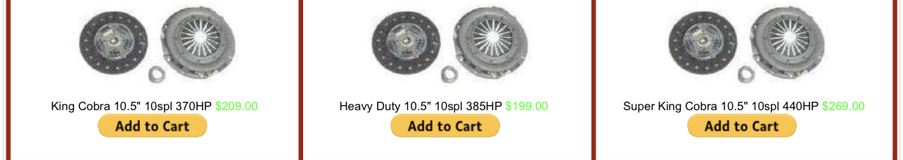

Ok yea I’ll call them tomorrow. On their website there’s a king cobra and a super king cobra and the one on eBay is a super as well. Is the super king cobra better or should I get the KC? My car is just a street cruiser I don’t do any tracking.
Tell Walt what you want, power level wise and make sure to tell him you want the lightest pressure plate feel if that's what your after he will hook you up, I just linked the eBay one to show the orig king cobra pressure plate since it was pictured and doesn't look like a generic stock photo Some of his blue printed ones where even lighter but held more power.
Yes but its cheaper on his website so you may want to call them...
So I spoke to Walt and he told me the standard king cobra 370hp is what I’m looking for. He said it’s a good clutch with a nice pedal feel. He told me I may want to consider the super king cobra in case I ever want to add more power however I don’t have any plans on adding more power in the future so I just went ahead and ordered the standard king cobra clutch.

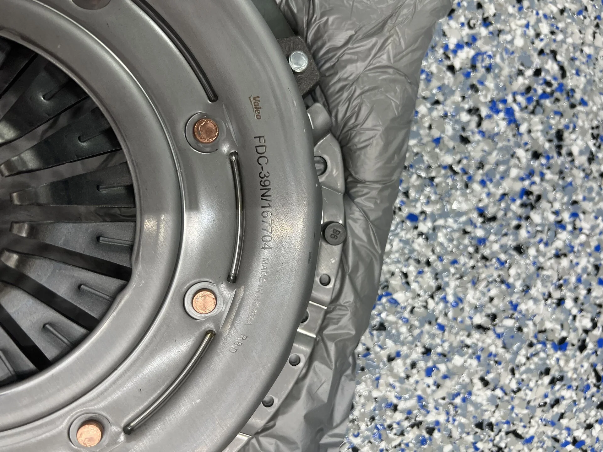

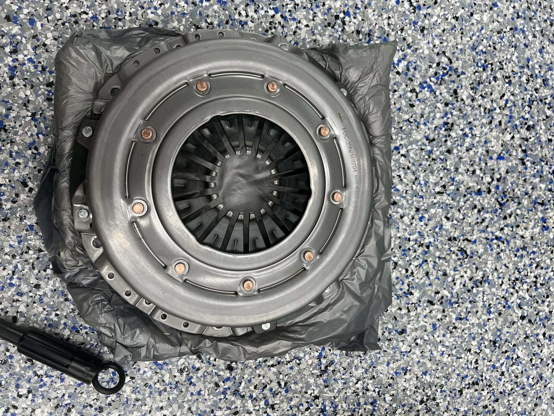

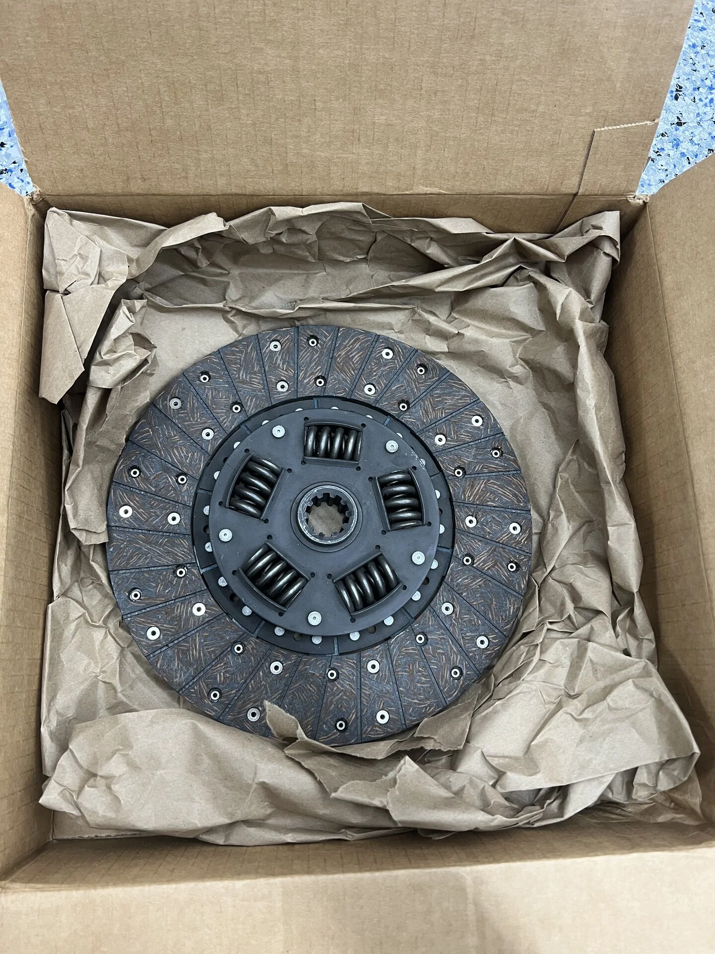

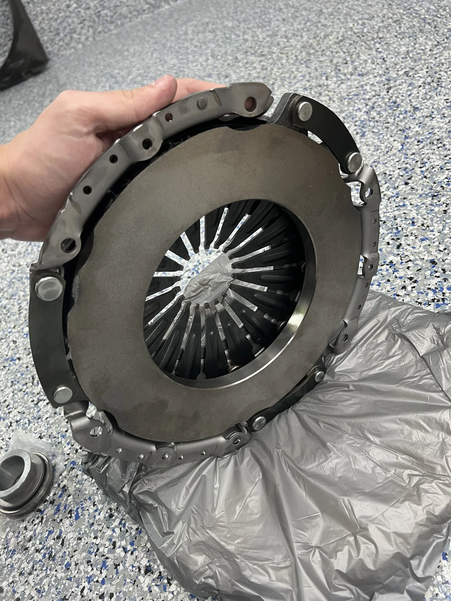

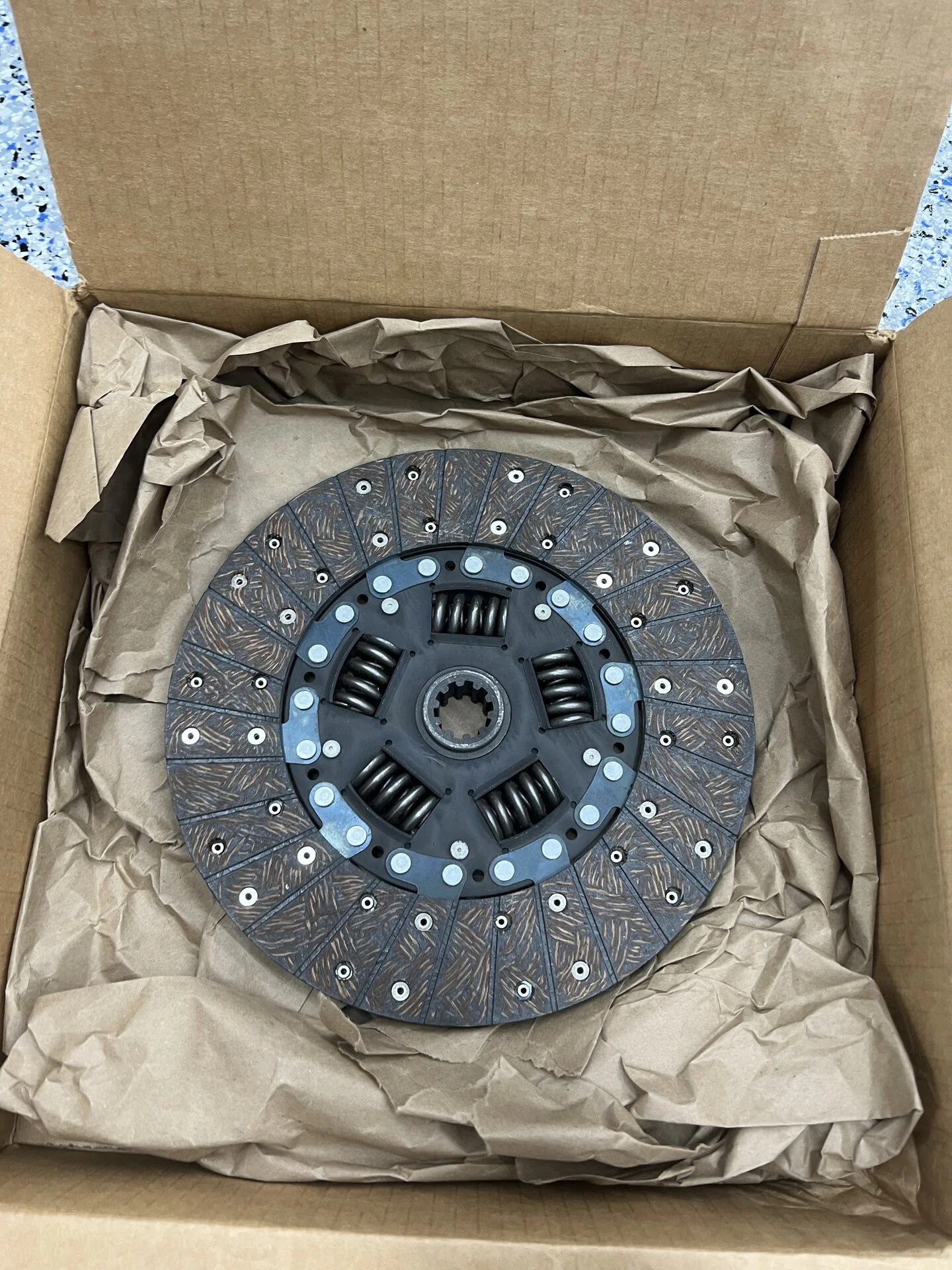

Clutch just came in today. Is this the real deal?
