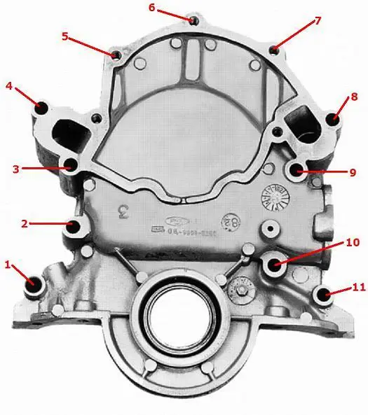

We need to take that info and just put it on a diagram and be done with it. I'll see if I can find something good to lay it over and PM you JR. Would make a great resource and could include a downloadable/printable file.

TIMING COVER and WATER PUMP bolt length and locations
All bolt measurements are measured from the underside of the bolt head to the end of the threaded bolt.
All of these bolts are torqued 12-18 Lb-Ft
All bolt threads are 5/16-18 pitch; stud are 3/8-16 pitch
#1---- 2-1/4”---- stud 13/16”--- stud thread pitch 3/8-16
#2---- 2-”-------- stud 13/16”--- stud thread pitch 3/8-16
#3---- 3-7/8”
#4---- 3-7/8”
#5---- 2 3/4”
#6---- 2”
#7---- 2”
#8---- 5-1/4”…. See Added notes below
#9---- 5-1/4”----stud 1-1/4” ---stud thread pitch 3/8-16
#10---2”
#11---2”
***Not seen in Diagram***
#12---1”
#13---1”
Bolt and Stud purpose
Abbreviation ….TCC= Timing chain cover
#1… Clamps TCC to block, holds timing pointer at bottom. Stud retains the support bracket for the Air Pump.
#2… Same as #1 but stud hold top of timing pointer
#3… Clamps water pump to TCC and TCC to block
#4… Same as#3
#5… Clamps water pump to TCC
#6… Clamps water pump to TCC, stub holds accessory bracket for A/C Compressor
#7… Same as #6
#8… Clamps water pump to TCC and TCC to Block…. See added Notes below
#9… Clamps water pump to TCC and TCC to block
#10. Clamps TCC to block
#11. Same as #10
#12. Clamps TCC to block (At top near bottom of lower intake)
#13. Same as #12 (At top near bottom of lower intake)
Added Notes:
All Fox-Body cars are not the same.
The numbers with length and location that I’ve provided above were for a 1989 GT with A/C, Power Steering, Stock Alternator, and the Air Pump in place.
Bolt only for position #8 is correct for 1989. However bolt and stud combo is correct for 1990.
