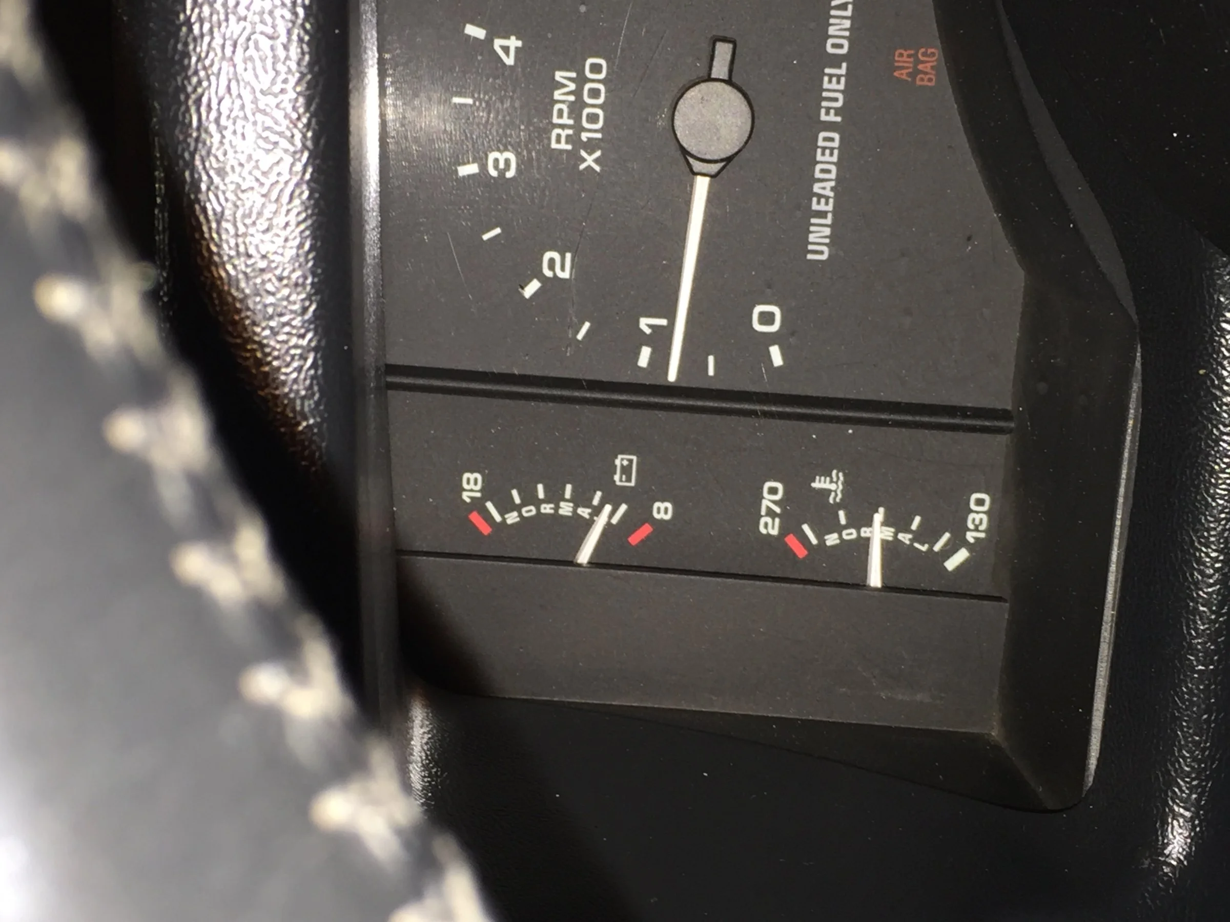

Hello. I’m thinking of putting in a water temp gauge. And I just wanted to know, if you have done that, where did you install your gauge? My factory one reads higher than I’d like after new aluminum radiator, water pump, thermostat, coolant hoses, temp sending unit....pic included of highest reading after driving. so I want to know what the temp actually is. Thanks! Just not sure where to mount it where it would look good in a stock 1990 interior.

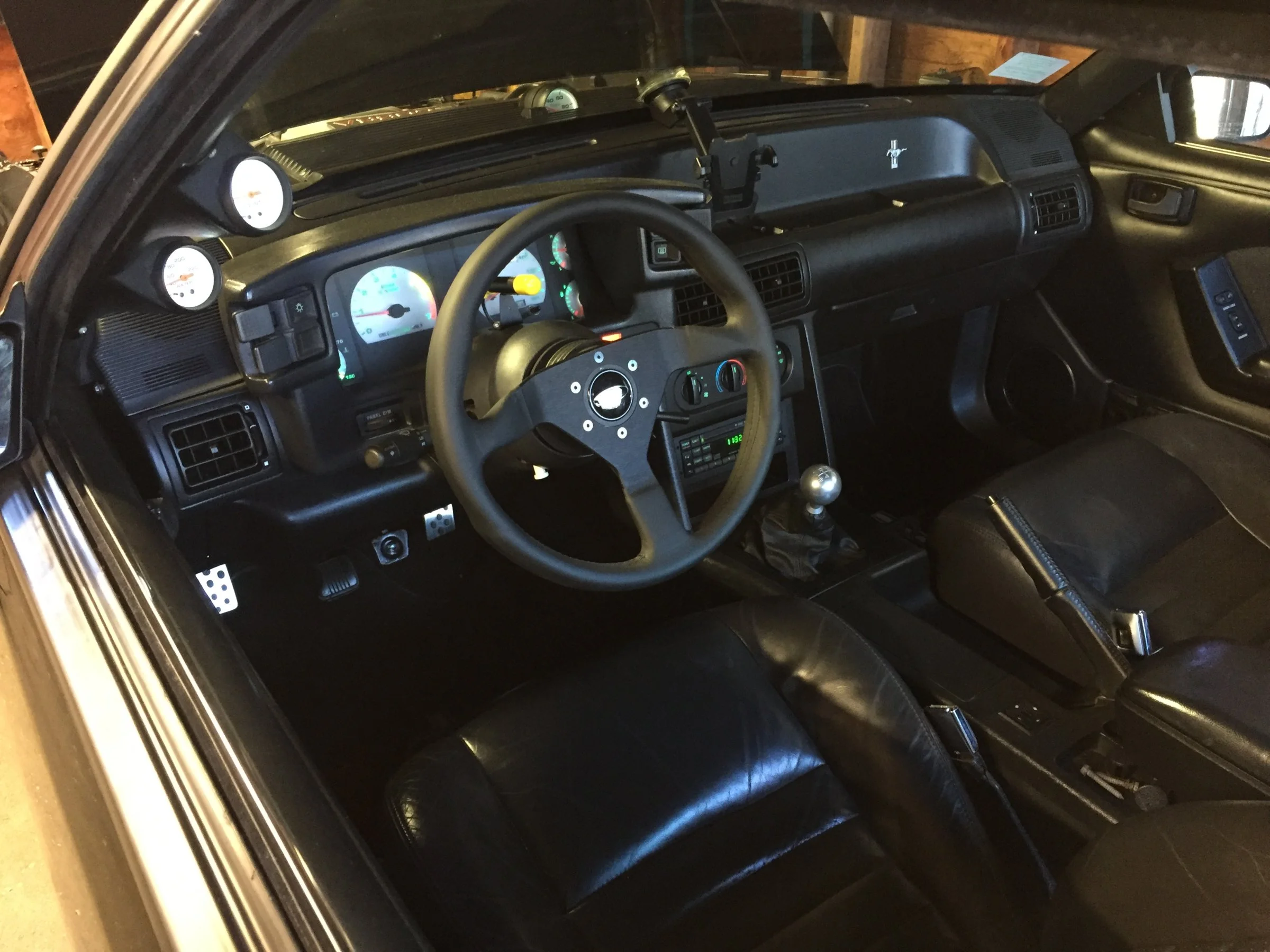

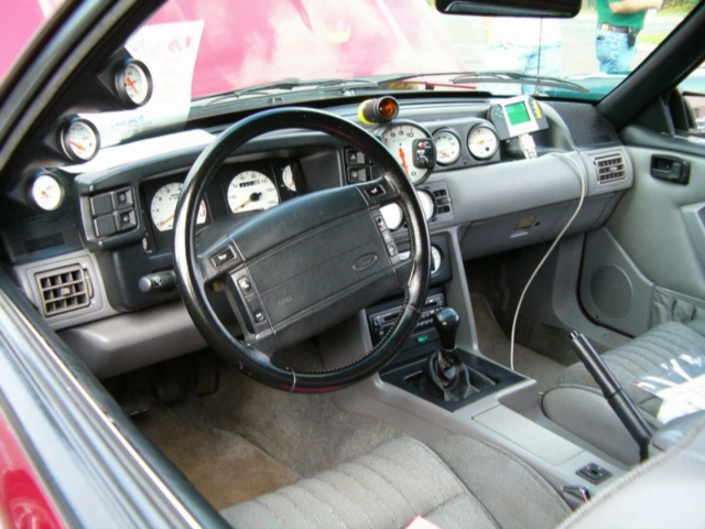

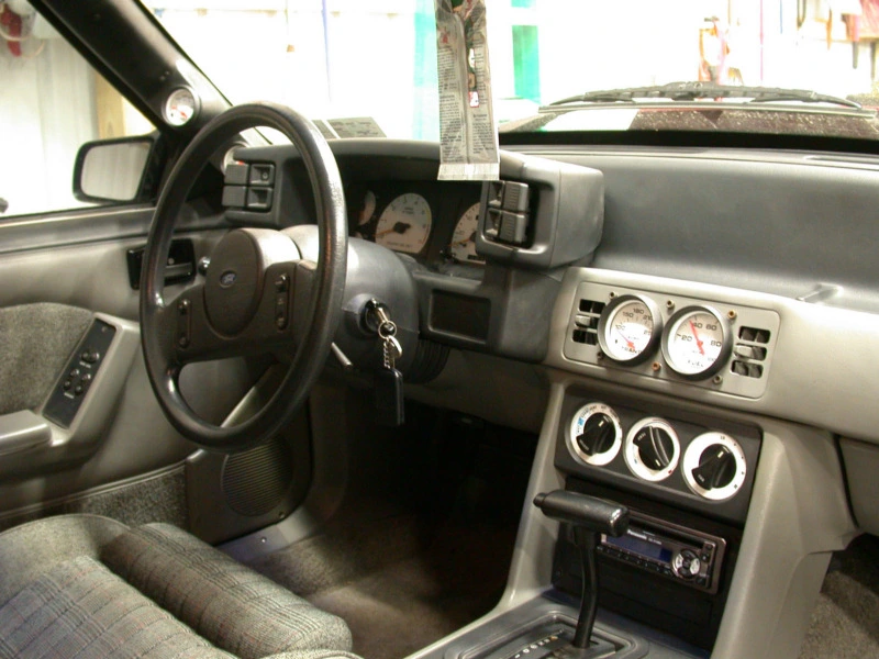

I've put them in two areas: rear factory sensor location and moved factory over to other side and also in the radiator neck. I've usually put the gauge in a center vent 2 gauge pod that retains vents or on pillar. If you have a cowl you could get away with mounting one in that. Personally I'd put it in a vent gauge.
Few pics of my 89 and 93 set up.

Interesting, thanks for the pics.

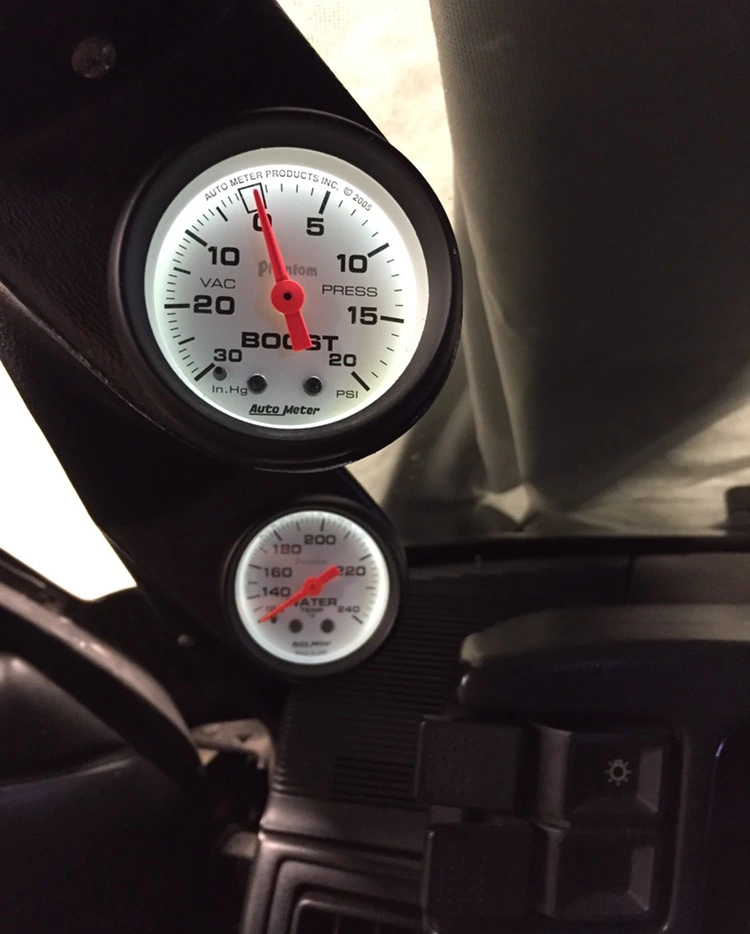

I put a mechanical on an a pillar. Pita. Next time I'll go electric or spring for full sweep electric

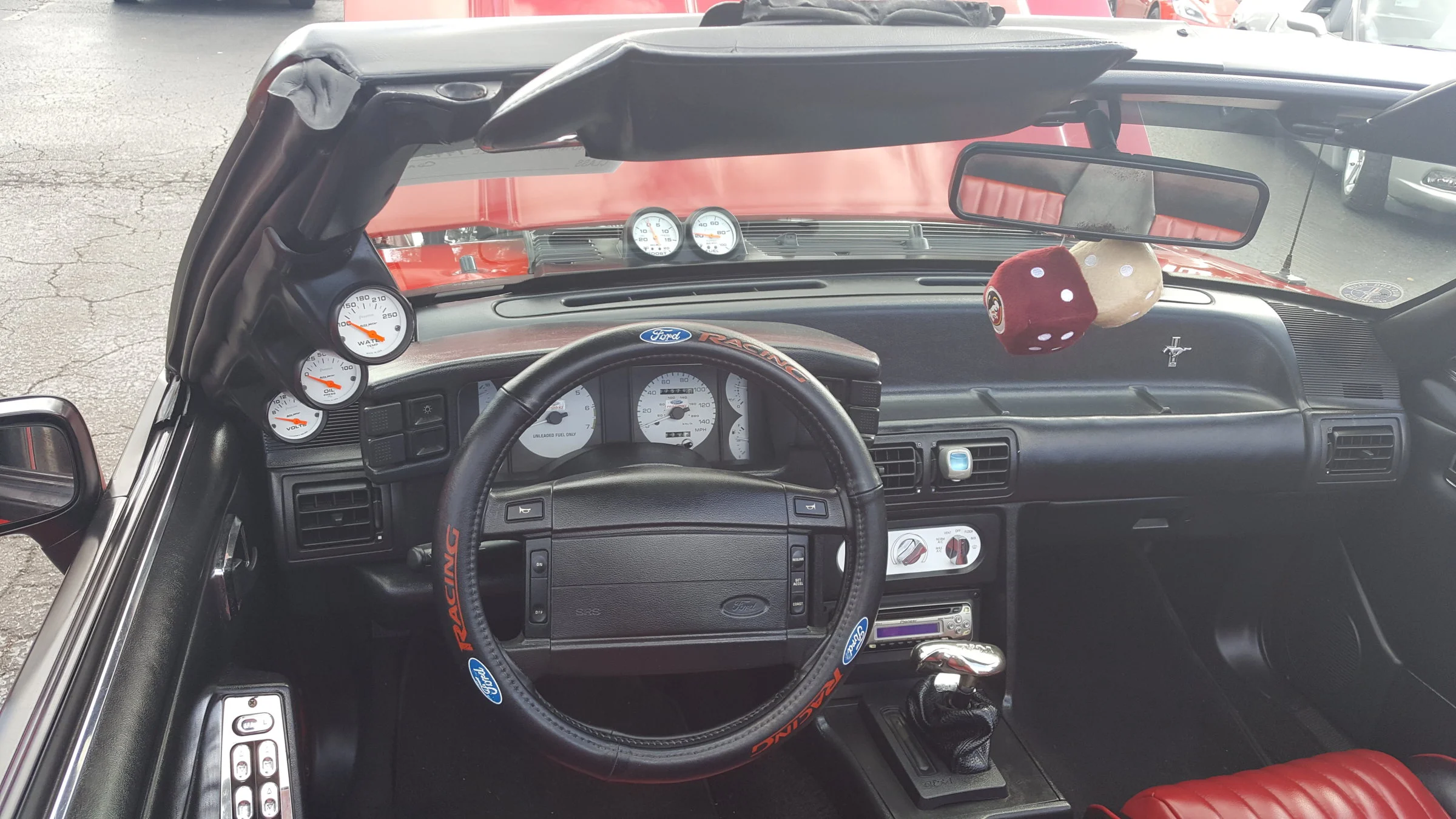

i've installed them in several locations
  • A pillar
  • center console below the radio
  • instrument cluster in a 5.0 Florida panel
  • on the cowl
There are many ways to do this. It is all up to you.
Personally, I am not a fan of mechanical water or oil gauges in street car, as I dont want to take any chance of hot liquids spewing all over the interior if a line breaks.

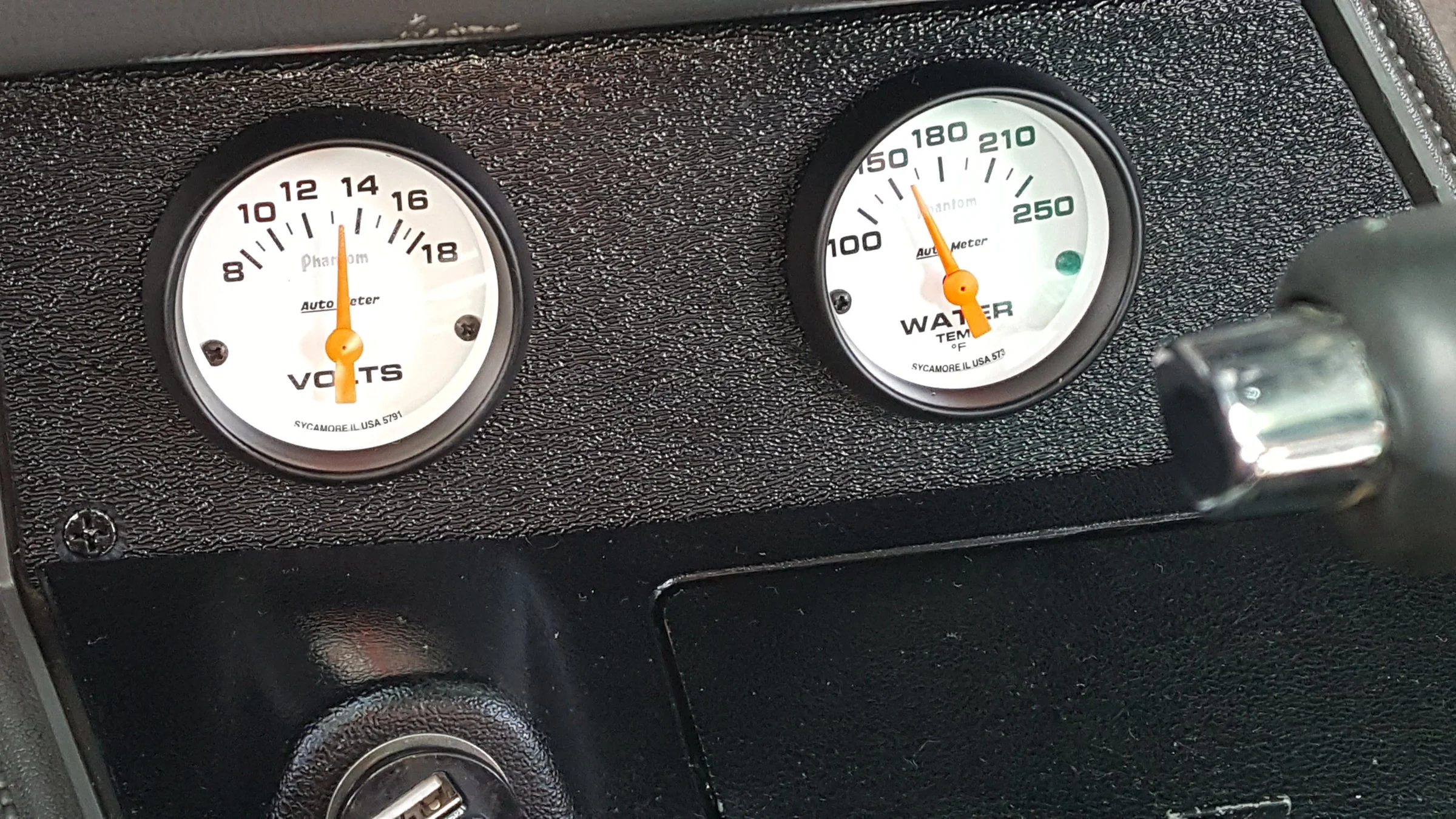

center console of my 86

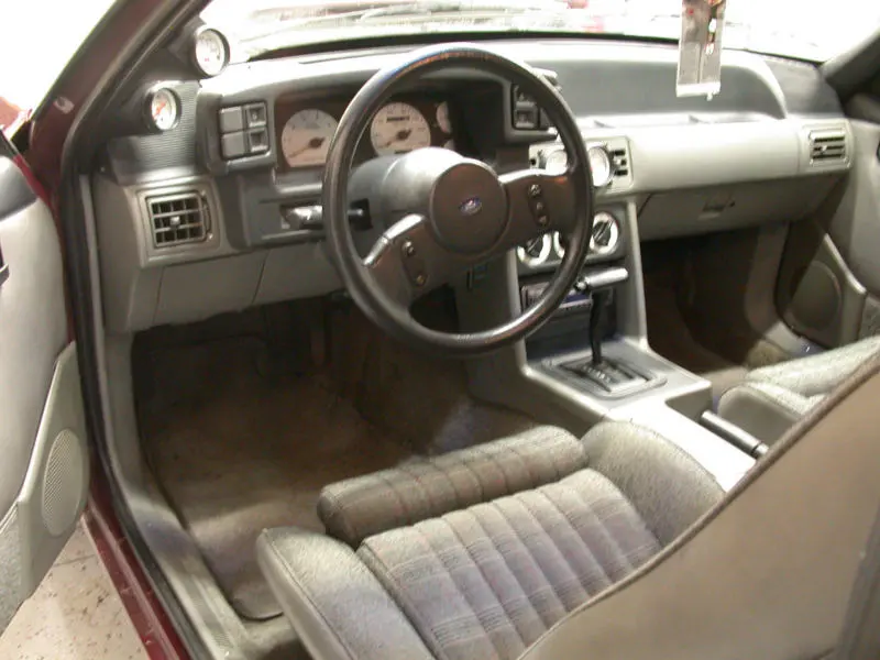

A pillar pod in my 90

Nice. I got a mechanical for the pillar on the way so I’m sorry hear it was a pita. Guess I’ll know why after I install it.

Well dang, I’ve got a mechanical gauge on the way because I thought they were better just from the little bit I’ve read. Too late now but I guess I’ll do some more research on them.
oil on the cabin is why I removed my mechanical oil pressure gauge. The nylon tube they give you cracks. Really need to run a braided stainless line in.
Mechanical water temp guage uses capillary tubing which is a fluid bulb and long copper tubing. Can't bend or kink it, so routing to the a pillar is just difficult.

The issue with the multigauges is that each time you check a box you are adding $100 on top of the staring point of like $250.
