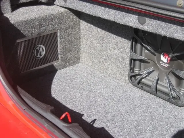

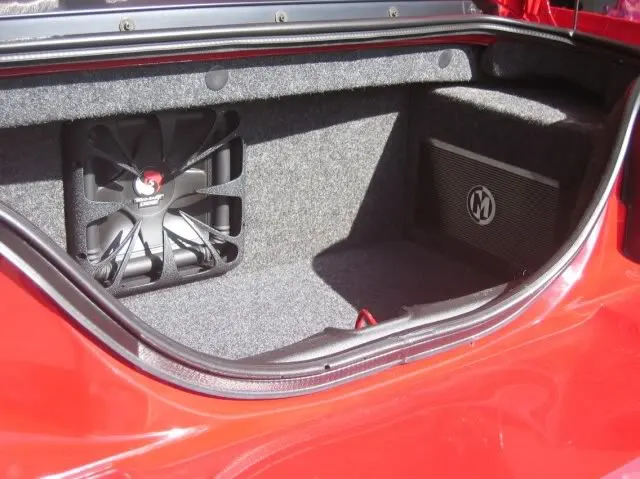

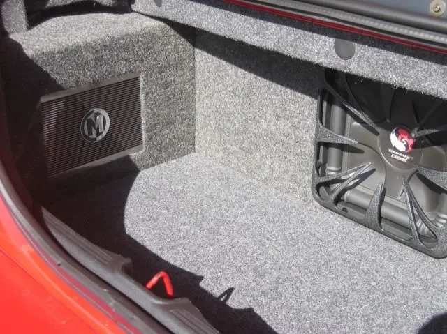

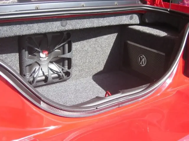

1995 GT Convertible. Bought some amps that are too big for stock location behind seat. Any good ideas? I have a custom sub box in trunk. Can i mount amps to eaxh side of box? Too late to return amps as they have been in the garage for a while.
Mounting them on the box is fine, sometimes it's about the only option. This is what I did in my brothers 99 vert...
