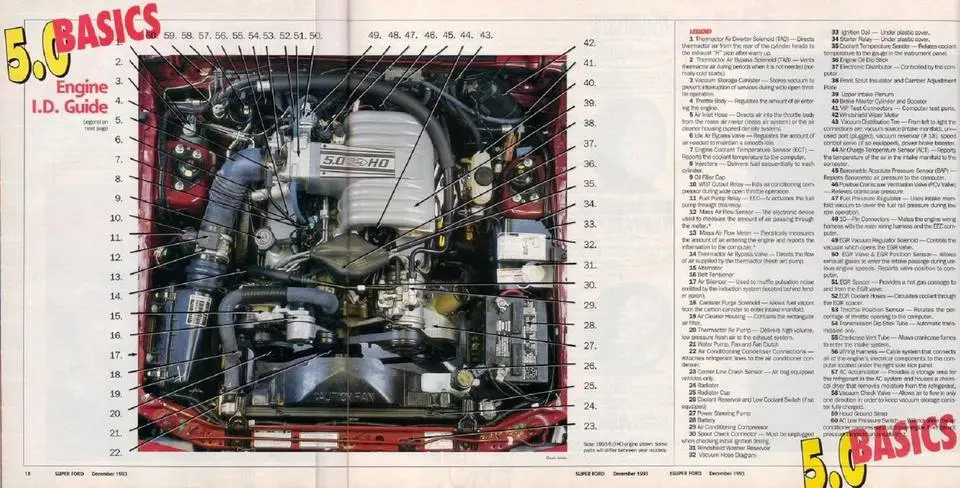

Where is the MAF?
Not sure I understand your description - 90 engine/tranny in an 81 body?
The maf should be located in the air inlet piping in between the throttle body and the air filter. Hard to miss - has a plug from the wiring harness plugged into it.
here is a pic of the stock setup
Pre 89's were speed density engines, exluding California 88 cars. Another way to check to see if your car is speed density is to see it the BAR/MAP sensor is connected to the intake. It's the black box thing mounted on the firewall right behind the upper intake.
