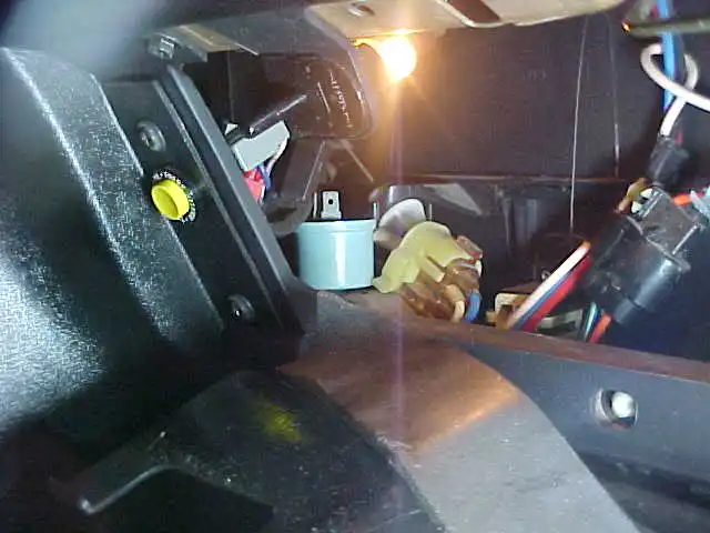

I used the search function. I found the following pic.

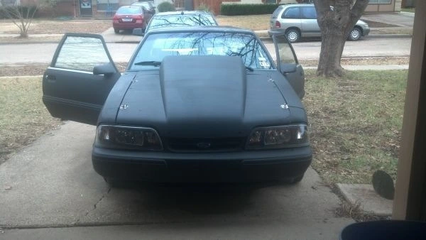

the previous owner installed one piece headlights..
arent the inner lights on these mustangs parking lights?? why are they blinking??

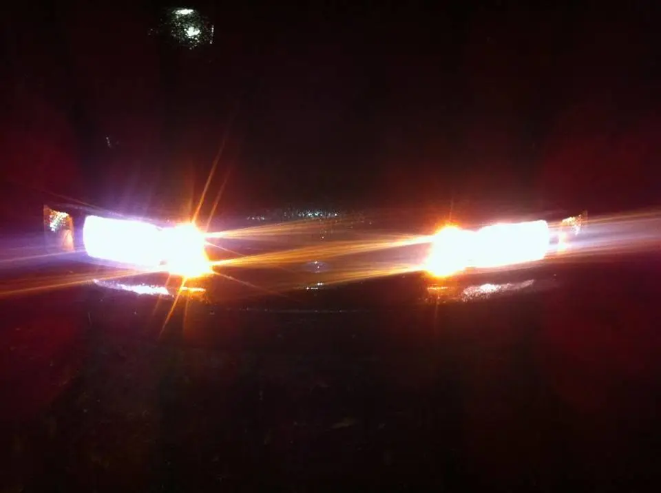

and pardon the picture quality.. but when you press the driving light switch all the way in.. all the lights up front come on like this... something is screaming at me that this wiring job is hacked..

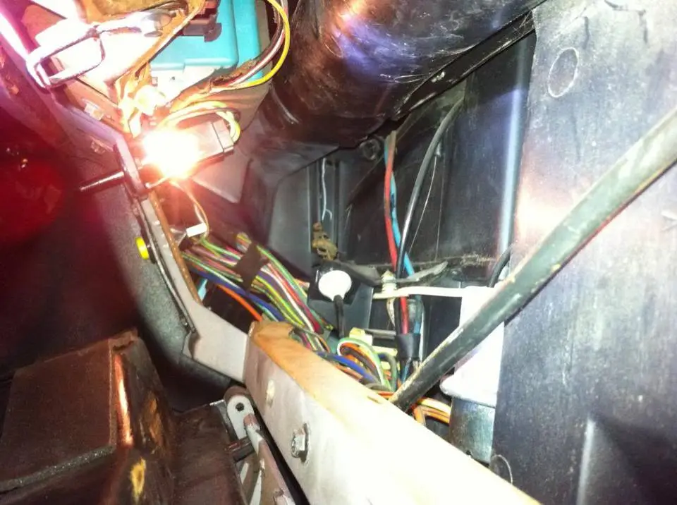

OK, because i don't like the leave threads open.. i found it.. 30 degrees outside and raining.. and midnight.. lol.. i found it!! i had to remove the radio and use an inspection mirror and look upwards and slighly right to see it, but as far as reaching with with the radio removed, seems almost impossible... however removing the radio did allow me to see it with my mirror... its in a hard to see spot..
i reached my hand through the glove box and found it was retained on a metal support.. so in the spirit of customization.. and after many failed attempts at removing it.. i grabbed it and snapped it off... honestly its junk.. and the new one doesn't have a mount regardless... i plugged my new one in and presto.. i now have turn signals and hazards!!
