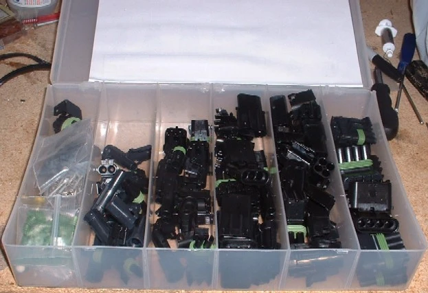

I ordered a connector kit for $69 from:
https://www.casperselectronics.com/...n=PROD&Product_Code=103005&Category_Code=conn
Here's what the kit looked like when I opened it:

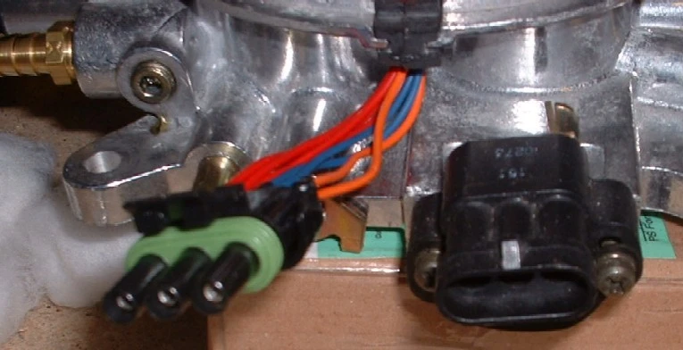

Here's what the connectors look like. In this example you can see the male 3pin connector I made using the kit. The female connector is for the TPS sensor in the holley throttle body I'm using.
Holley also uses GM Weatherpak connectors.

They make more than 4 pin connectors, just not in the kit. I personally have a 5 pin connector and have seen 6pin. Tho I would think 8 pin is probably the largest out there. The weatherpack connectors were built with up to a 12ga wire/connection in mind.
I've found that the need for anything more than a 4 pin is pretty rare unless your looking at disconnecting the main harness.

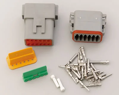

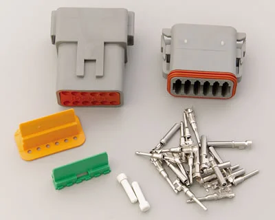

Hey, those are neat, I think ford uses the Deutsch style (or used to) on some applications. I have some from a junkyard that look a lot like that. I wonder how high you can go on the current for each pin...

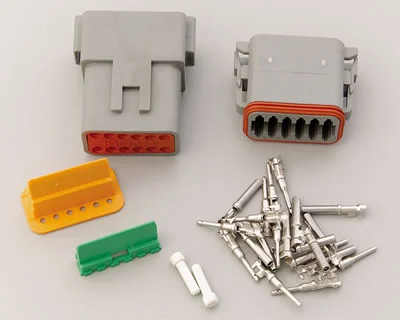

those are perfect...thanks HUEYPILOT for the recommendation. Just to let you guys know, I believe those crimp ends take special crimpers ton crimp them because they are so small. Im going to pick a couple up. I did find a place that sells the crimp ends that fit into the OEM fittings if you guys ever need. Im thinking buying a ton of new pins and junkyard for the fittings will be way cheaper.

I use those connectors on all my vehicles. I solder the pins to the wires for the strongest connection by wraping the crimped part around the bare end of the wire (with just pliers) to hold it in place so it makes it easier to solder. You can easily take them back apart w/o any special tools like pin pushers or extractors that are required on the Military type "cannon plugs". I don't recall the amp rating for these connectors but I have used them in rear brake lights and electric fans with no issues.

In the summit listing, it says the connectors accept up to a 16ga wire. That's only about 10amps. Enough for brake lights, but not an electric fan. Maybe you can squeeze a 14ga wire in there, but then you're still only good to 20amps max.

20 amps will run just about everything other than an electric fan... I need them for the whole steering column, gauge cluster...etc...

Remeber that you can only run 20amps if you use 14ga wire tho...I don't know if it would be possible to do that. You might be forced to use 16ga or smaller.
If you are indeed limited to 16ga, you may have problems.
Also remember that in normal automotive wiring, you don't have a seperate wire that goes to the fuse block/ground for each electrical accessory. Most accessories share a circuit.
Look at the fuses in your vehicle. I think you'll find a lot of them are 15amps or higher.
