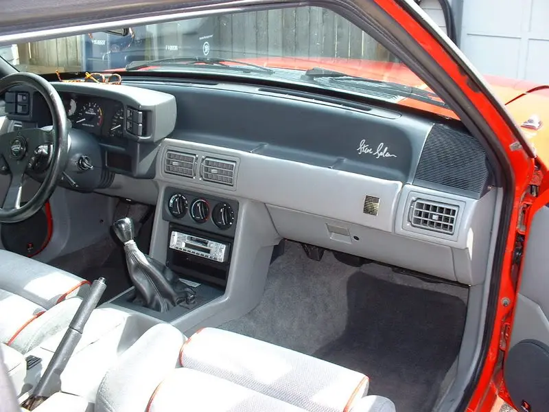

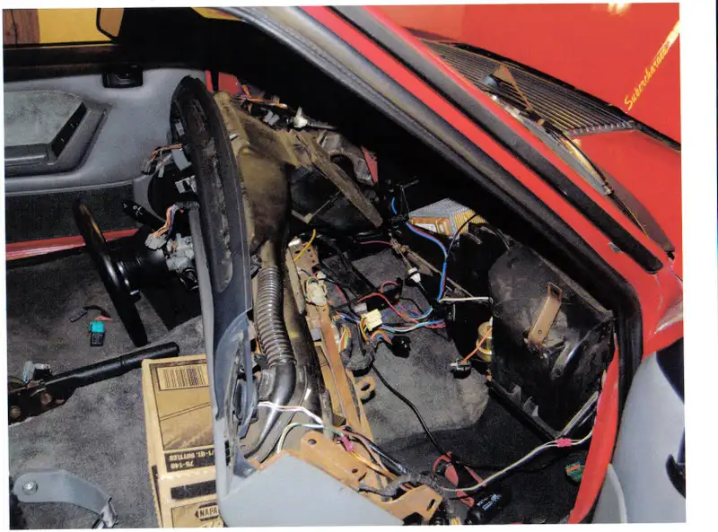

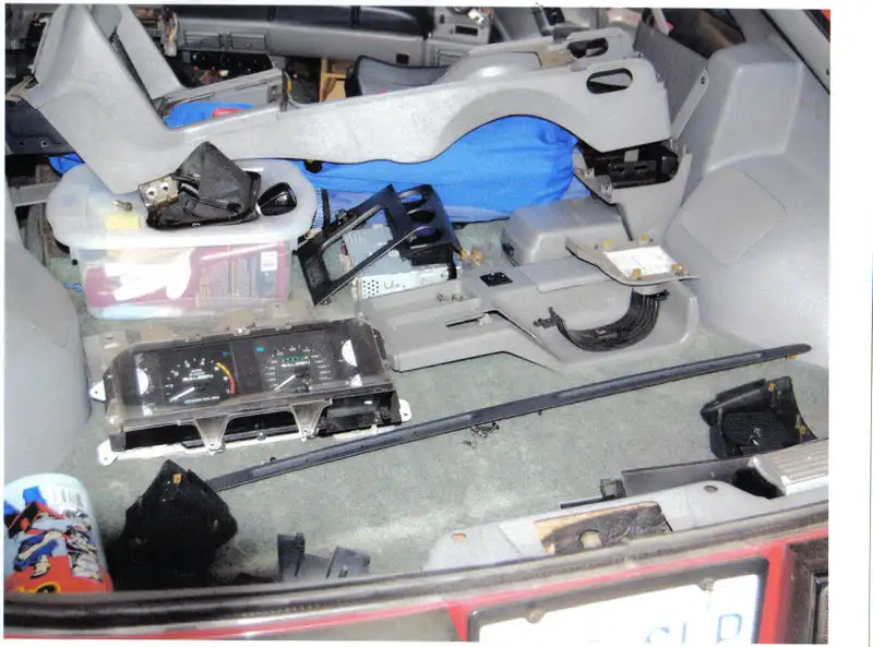

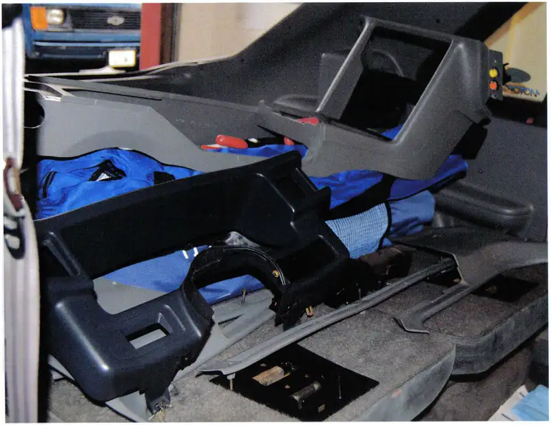

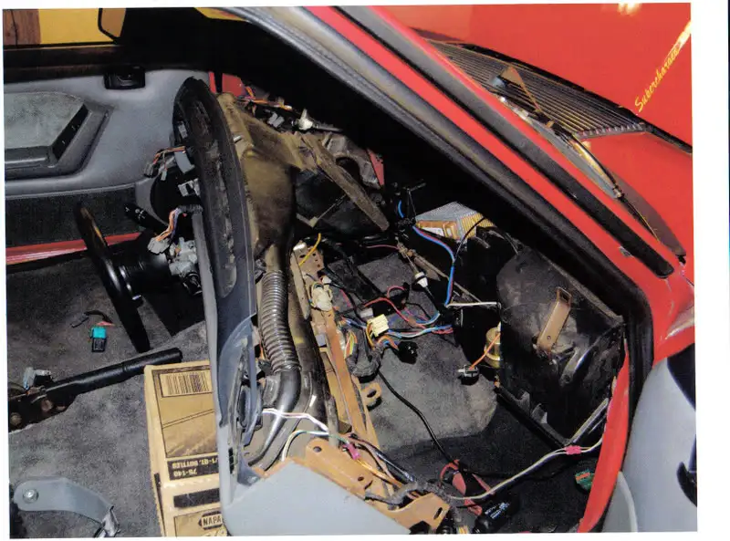

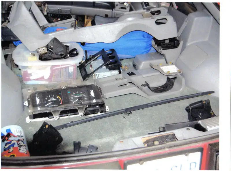

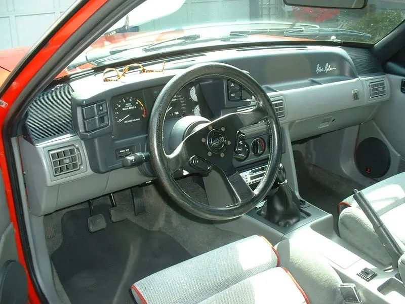

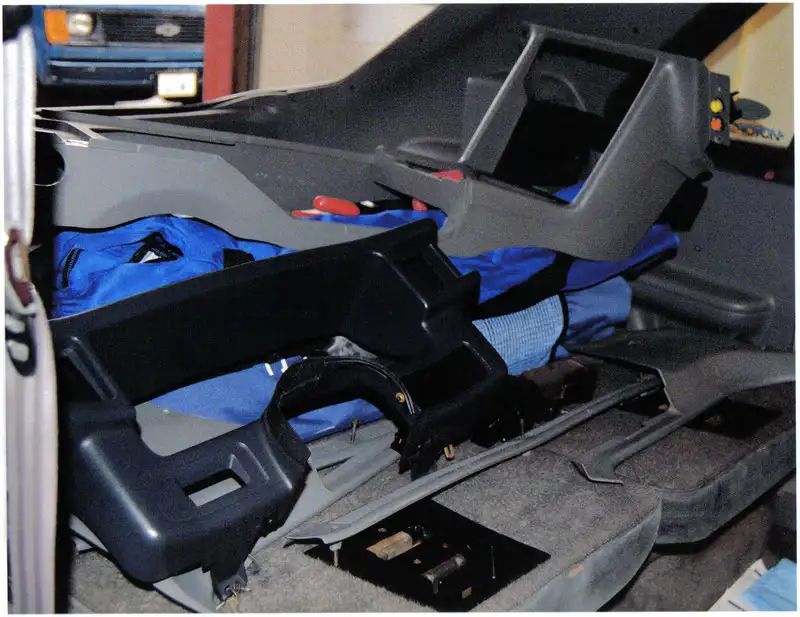

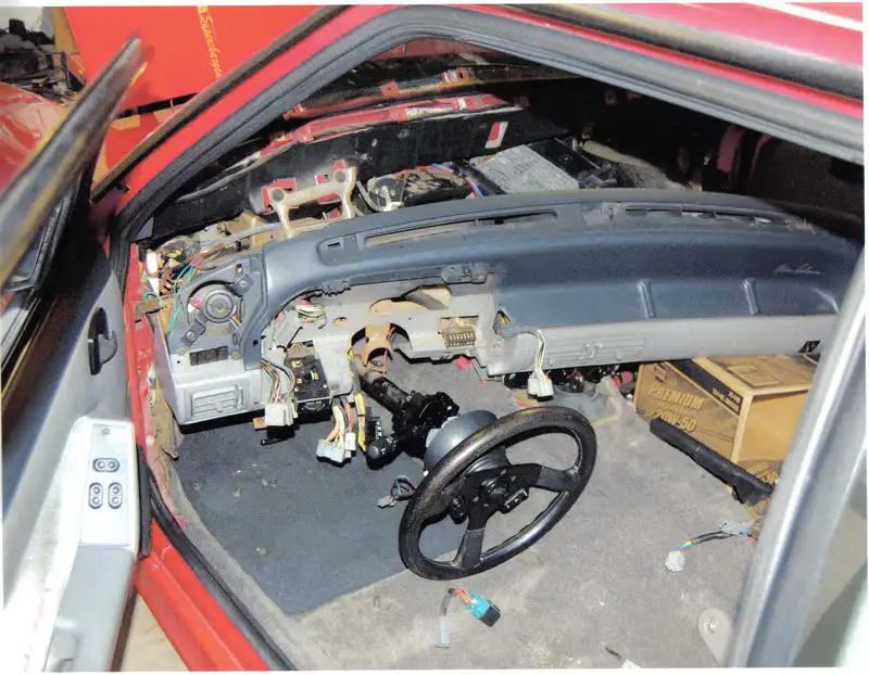

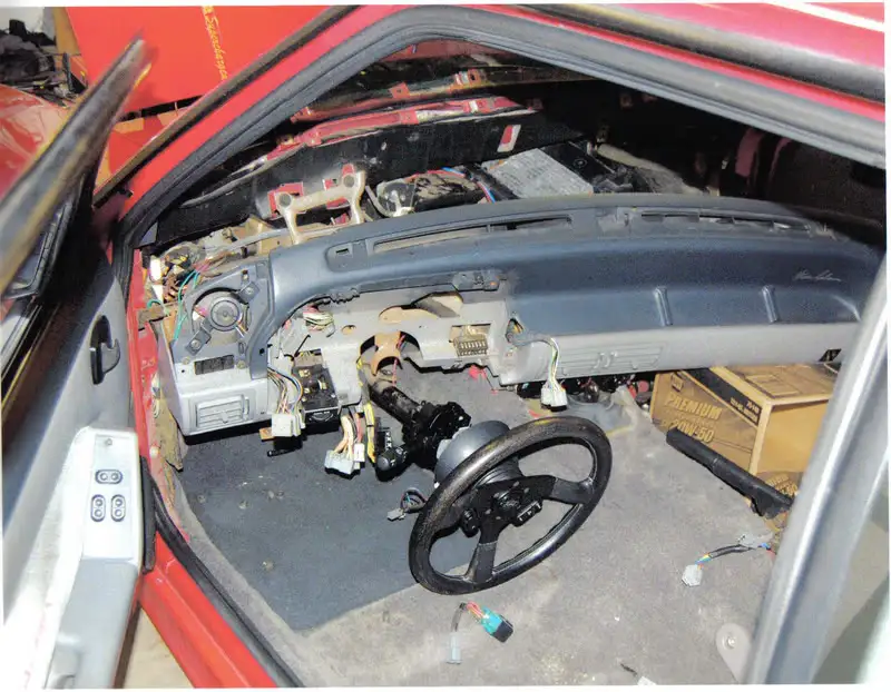

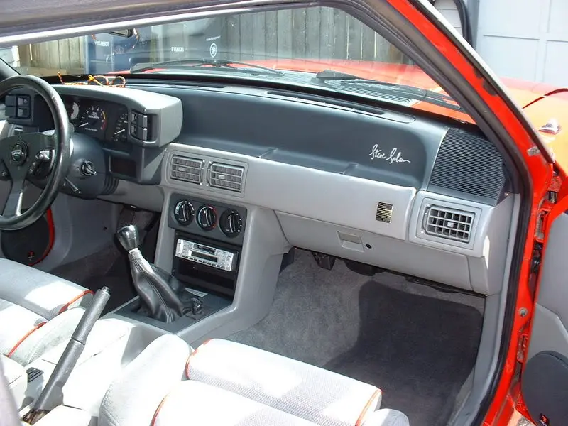

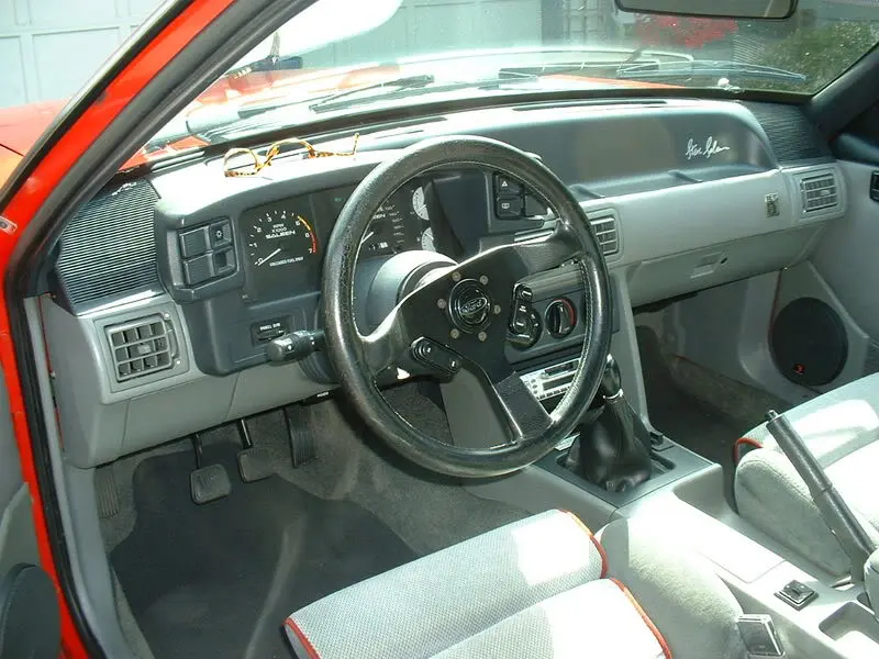

I have pics of my car torn apart,
Here is how it looks after
Good Luck

Just like you can see in the above photos, the procedure requires that you drop the dash into the front seats after relieving the steering column from its mount. At that point, the core change is really easy. I did mine in an afternoon.
