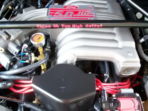

when i adjust i remove the vacuum line at the adj. fuel pressure regulator and plug the vacuum line with my finger or a small screw and adjust to 38-40 and then reinsert vacuum line....done.its easy for me because i have a fuel pressure guage permanetly mounted under my hood see pic...
