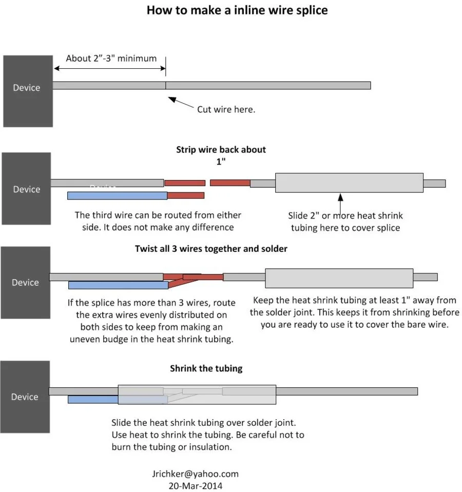

On any automotive wiring repair, the only correct way to do it is to solder the wires together can cover the splice with heat shrink tubing.
how-to-make-a-running-wire-splice-jpg.556558
