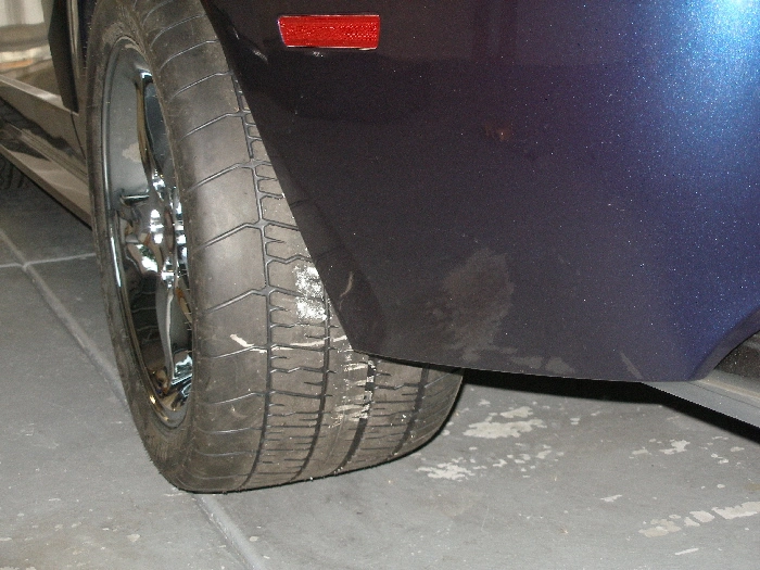

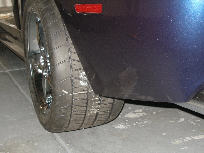

i got some 315 BFG's....anyone else have trouble with theyr'e tires rubbing on the body?.......my car has stock suspension.....it isnt lowered
well, BFG tires run big as it is, but then you squeezed 315s onto a 17x9 wheel? My guess is you have some excessive tire bulge going on, which might attribute to the rubbing problem. Is it rubbing on the inside or outside of the tire? You could either run a spacer, or roll the fender, depending on where it is contacting.

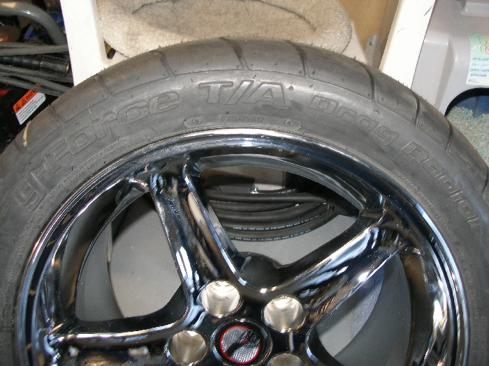

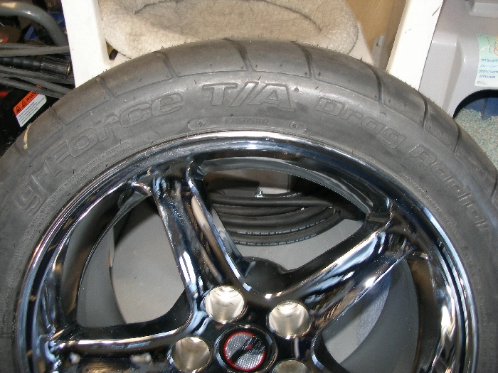

315-17 BFG's on a 10.5 rim no problems rubbing here. I'm lowered with a Pro-Kit.
