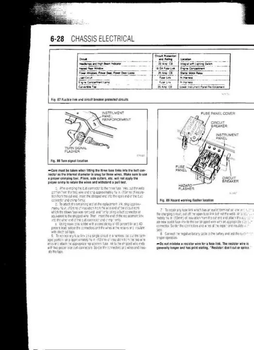

car is a 91, cant find the damn thing for the life of me. I dont see anything behind the radio besides two relays, and nothing under the dash, can someone tell me what exactly it looks like?
the turn signal flasher is mounted on the instrument panel reinforcement above the fuse panel and the hazzard warning flasher is mounted in the fuse panel
look at diagram below hope it helps...
