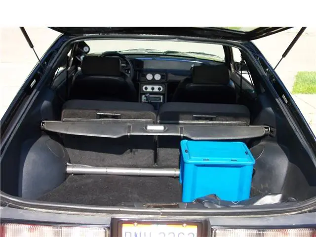

The Moroso blue box is installed in mine as well. Seems pretty solid.
