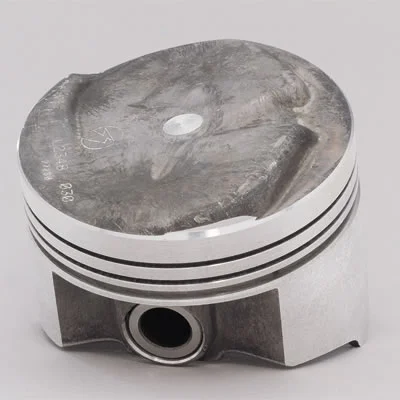

Yeah, that piston is definately a compression builder.
Much more aggressive than stock...
