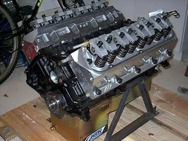

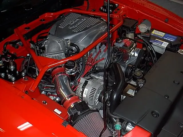

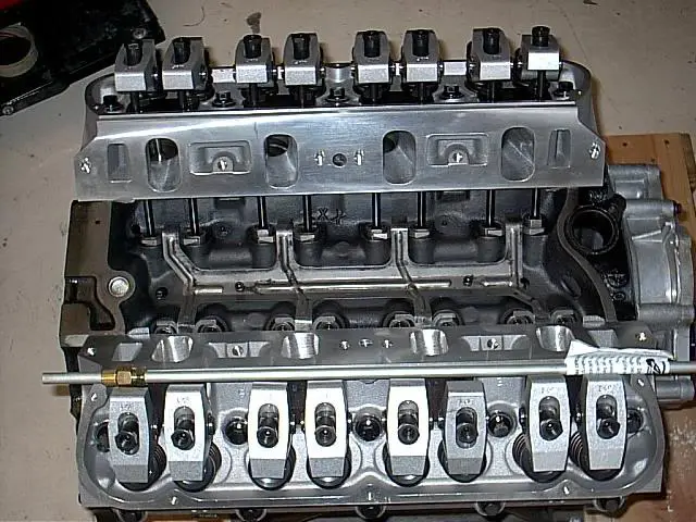

AFR 185's on 347 with custom Comp cam, Holley Systemax Intake with ported throttle body outlet, ported elbow, 75MM Throttle body, 80MM MAF, 30lb Injectors, 1-3/4" Ceramic Long Tube Headers with 3" collector, 3" Prochamber, 3" Catback exhaust. I should have went 205's and 38lb injectors.
Dude, that engine looks awesome! I imagine that thing pulls pretty hard. Nice! :cheers:
