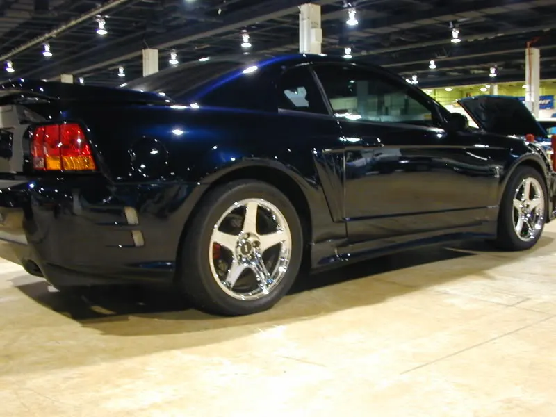

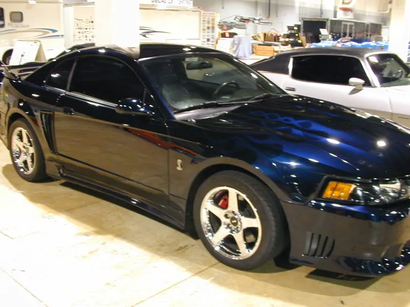

And as for the 32v, here it is...
Along with the dyno numbers...
The 32v hasn't been to the track since the new numbers but on the old stock motor before I snapped some rods in it I had it singing 10.9 @ 126mph. Now once I get the 3650 transmission to ProMotion I should have it running in the 9's at around 140mph on nitrous.
So no...I definately can't walk my talk. Suck it up big boy and :Zip2:
