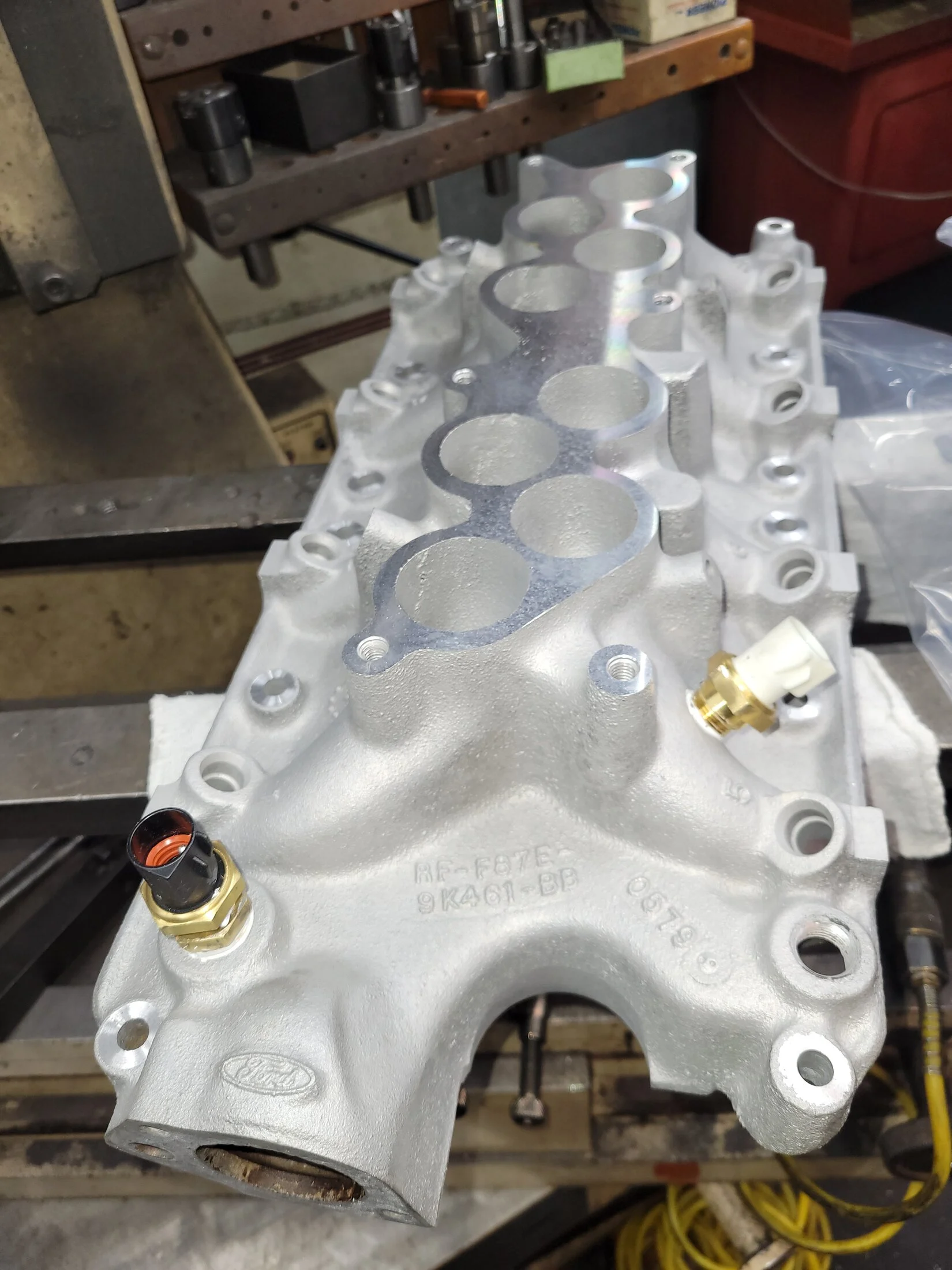

I'll go ahead and email them, I looked on the website and didn't see anything obvious. I did see that I'll need to test my CLT and IAT sensors to calibrate them in the program...They suggest I use a GM IAT sensor in the intake tube rather than in the manifold runner due to heat soak.... opinions?

Does anyone know how weldable an SVE CAI is? It looks the be decent quality...I think I would get an aluminum bungee welded to the intake tube for my factory IAT sensor. I would rather move the wire in my new harness then slice in a GM sensor.
I can't say from experience as I don't have a TIG and never tried with the old SVE intake tube I had for a while, but I'm sure if you have a TIG and know how to use it you could make it work.

PimpXS is also sequential for less money than the DIY.
I relocated the IAT from #5 to right behind the TB. From my experience intake air temps are only a portion of potential heat soak issues, the other being fuel temps. Relocation did help minimize swing in IAT temps, which did help some in ASE and initial cranking duty tuning.
