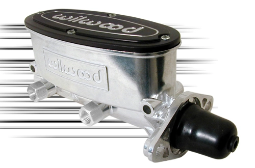

Damn, I bled mine in the car, guess I'll need to pull it and do it on the table.
Did you have a helper or put it in a vise?
Use a vise but just clamp it on one of the mounting ears, not the body because you could possibly distort the bore especially if it's aluminum. A medium phillips screwdriver works well for pushing the piston in...
68Restoman
Yeah, mine's aluminium, this is the one I have:
