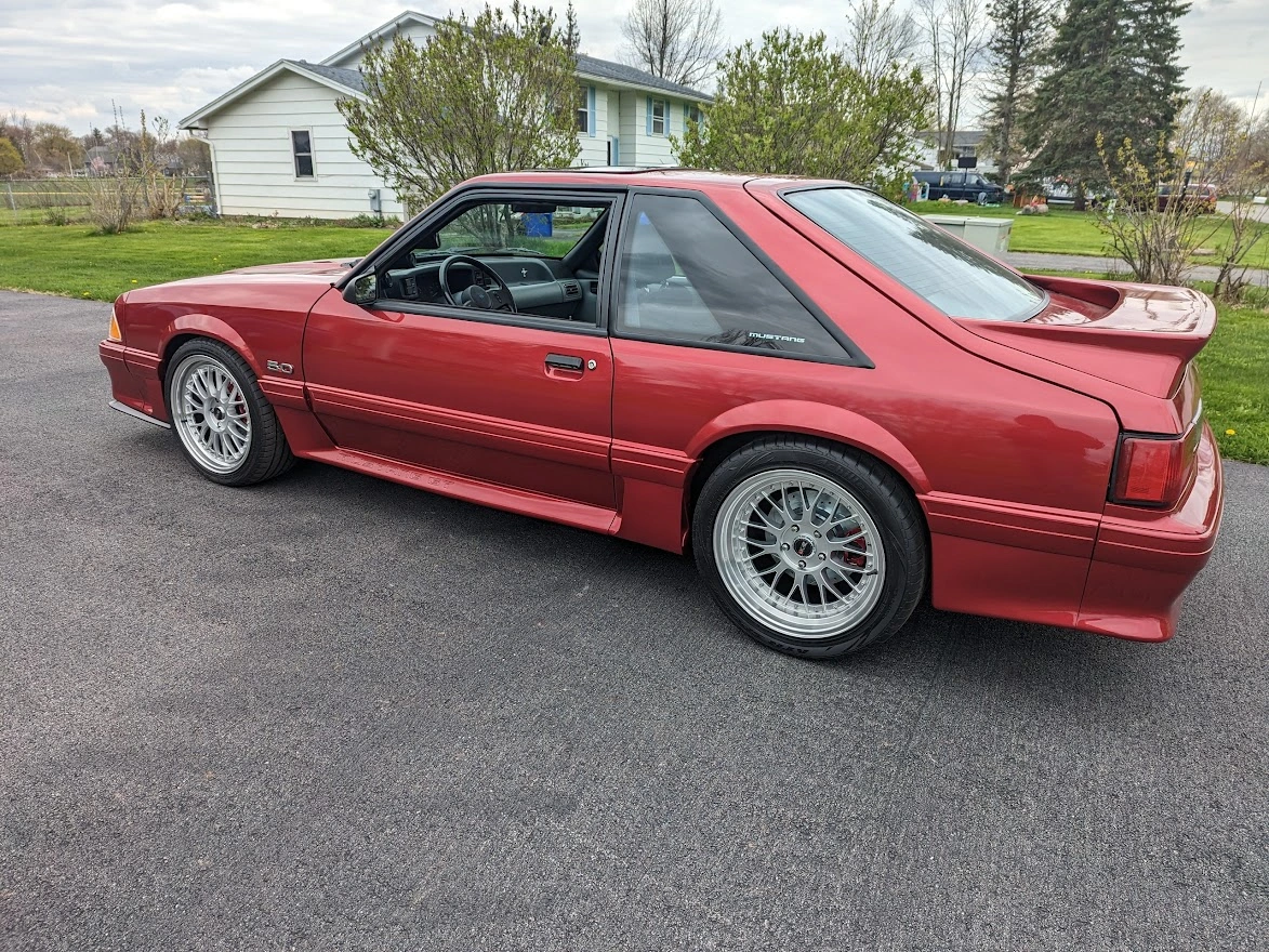

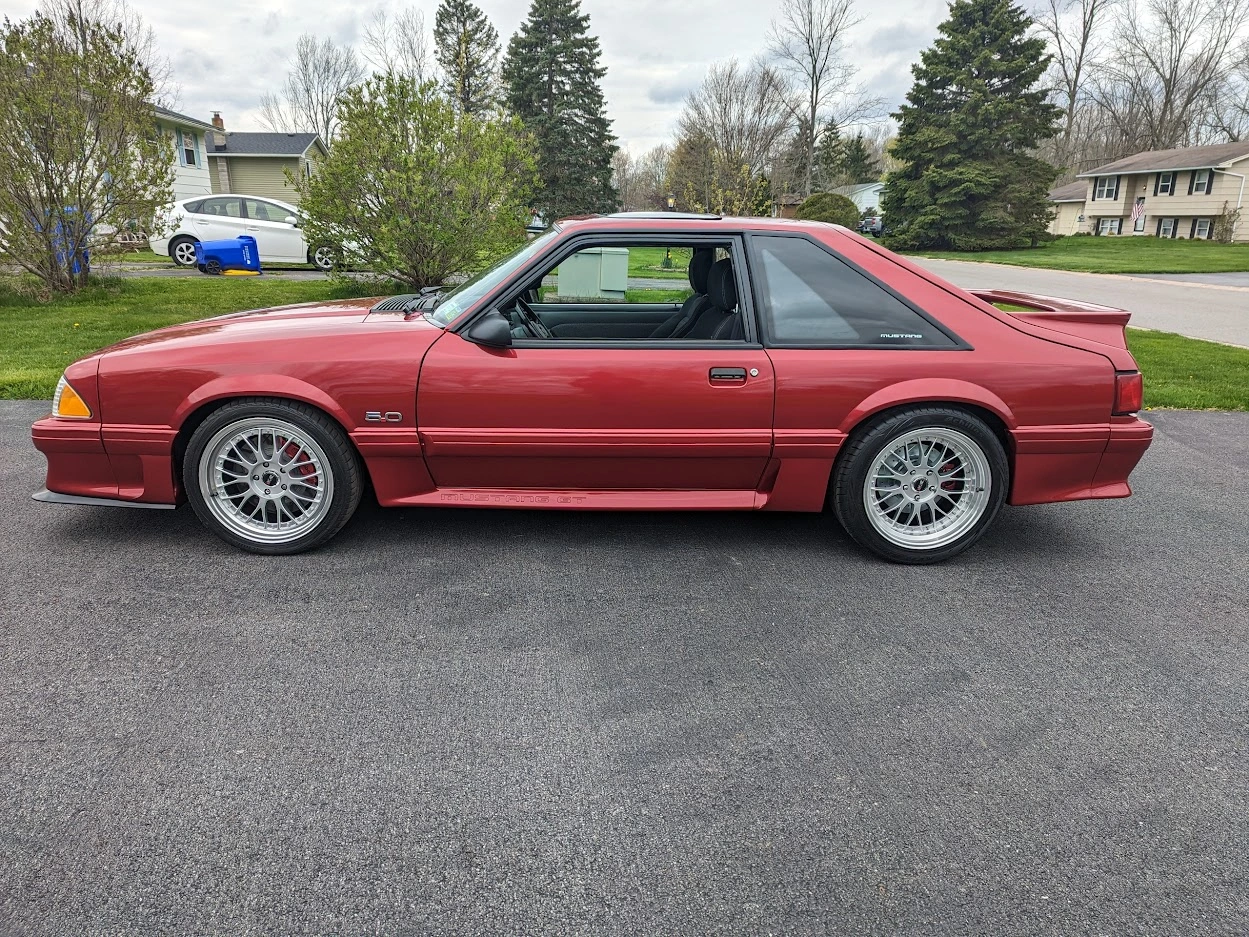

update,
I checked every fitting twice, removed the M/C and bench bled it outside the car, manually bled the brakes and glad to say the brakes are holding no more pedal to the floor, I also noticed the 3-2 port adapters were leaking a little bit so it could have been a combination of it all.
