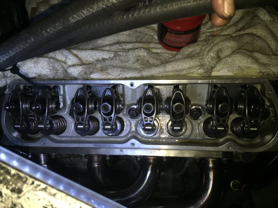

Any chance anyone's run the Ultra Pro Magnum's with stock (short) valve covers??
I guess I need this info before I order or they'll hit with my luck.
Pretty sure both these and the Ultra Gold will fit. Last set were same size as the Golds, I'm pretty sure, and there were no clearance issues. Removed baffle years ago when put "cobra" rocker arms on E7's...... the good old days

I run the original comp promagnums with stock covers. I had to modify the baffle area, other than that, no problems.
