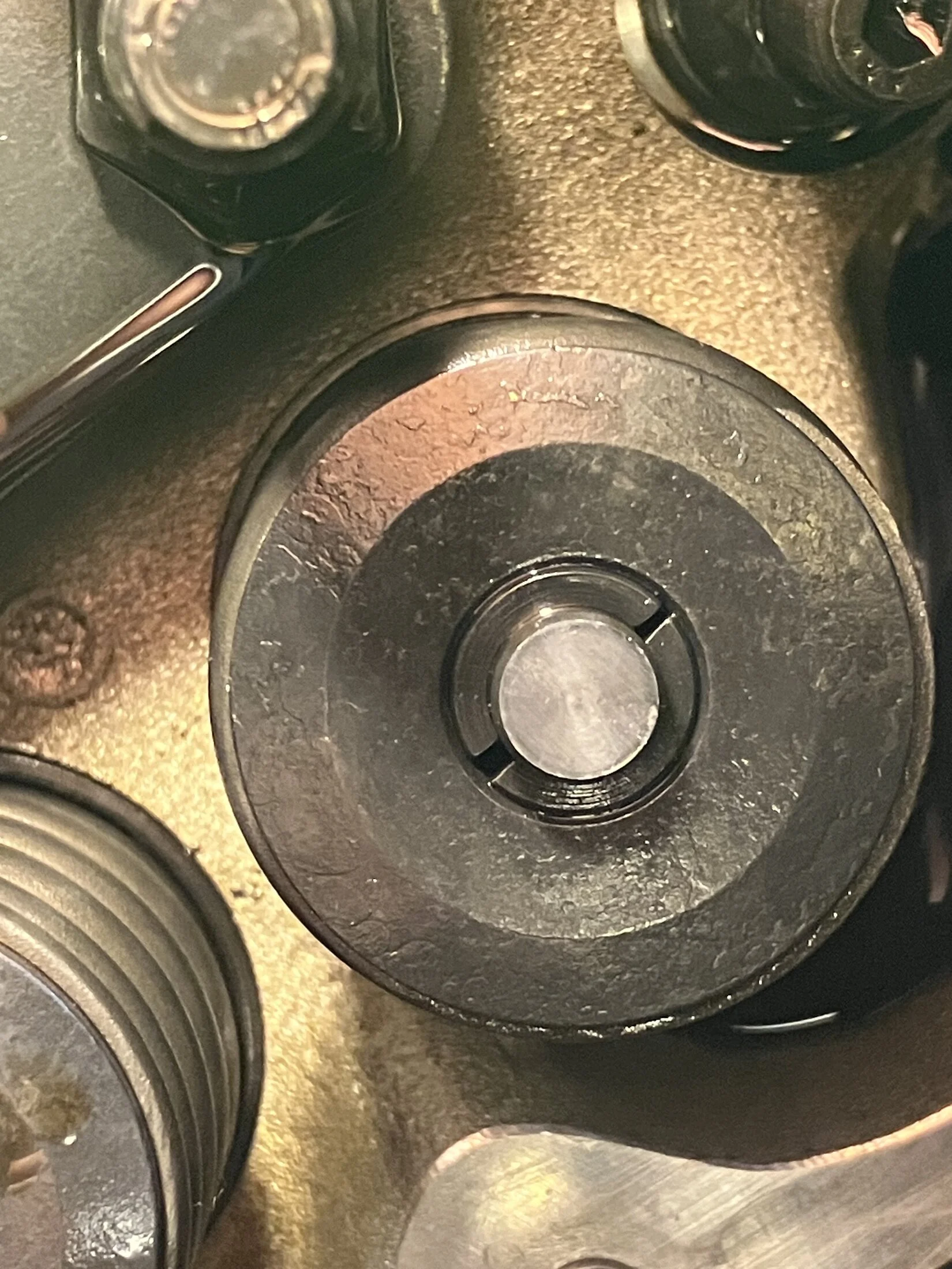

I checked the roller/valve tip contact pattern and it seems to be well centered so that is good.

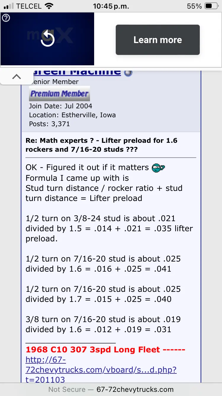

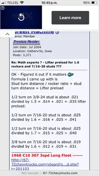

That is my understanding, the traveling on the studs are different:
3/8-24 1 full turn travels ~ 0.042”
7/16-20 1 full turn travels ~ 0.050”
Now what I’m finding, and don’t know why I didn’t realized this before is that the traveling on the stud is not linear with the preload traveling due to rocker ratio.
So 7/16-20 1 full turn (0.050”) will render about 0.082” of preload. Below I’m sharing where I got those numbers.
Enough of this, anybody with the same valvetrain/cam as mine, is you set up noisy as mine? Was noisy as mine? And if you solved it by adjusting the preload by how much without any issues? Considering that the plunger in the lifters bottoms out at about 0.100” travel…
