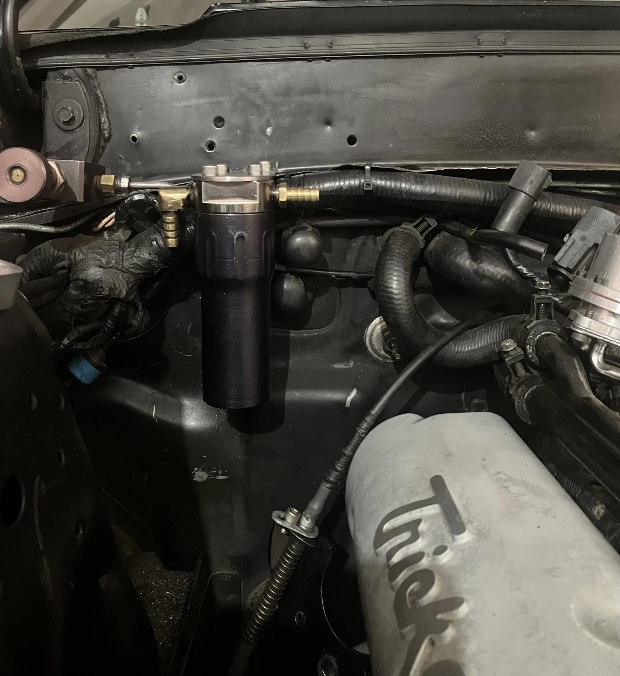

Right now I'm just working on the fabrication of a catch can, I think the compressed air water separator was letting some oil flowing into the intake. Below is my custom made Oil catch can :)
I've never did the valves adjustment that way. At this point I have all my valves adjusted to 3/4 turn preload for street application following the TDC/firing order method, have the valve covers bolted on. If the noise continues I will re-do them following the method you described.

I completed the oil catch can and put everything back together, fired it up and guess what?... Quiet!!! No more ticking clacking noises. took it for a short ride and no abnormal noises.
