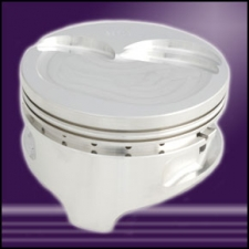

hey how's it going, wondering which pistons to buy for my 5.0 mustang gt, that will work with trick flow twisted wedge heads? i have a 85 gt but 4 years ago i had the engine rebuilt and he went and put in dome style pistons, with no valve relifes, now i dont know what pistons to buy, what is your recomendations. thanks.

find a 87-92 shortblock, throw the heads on that and use the stock cam:D If you want to buy different pistons go www.trickflow.com They have some pretty decent pistons. I have probe flat tops for mine and they have two sets of valve reliefes cut into them....one for inline cylinder heads and the other for tw's
Go to CHP.com,or just buy the proX forged from D.S.S.They both have great prices,DSS is in Illinois,CHP is in cali.Your choice.If your wanting to put pistons in it,go all the way and get forged aftermarkets.
http://www.rosspistons.com/auto_stocking_pistons_detail.php?cat=70&item=47
Ross pistons are really good. they're the pistons i have. very nice pieces. Will work with TFS twisted wedge, High Port, or Canfield Avenger heads due to three valve pocket design.

holy *****, $700 dollars, thats crazy, what are they made out of platnium hahahaha, you can buy a whole 347 stroker kit from chp for that price. what about keith black hyperectic pistons? theres a set on summit racing for 199.00 dollars, theres just so many that it would take you a month to know what ones to get. thanks alot.

Piston Style: Flat top, with two valve reliefs

would these pistons work on a set of trick flow heads, thanks agian.
