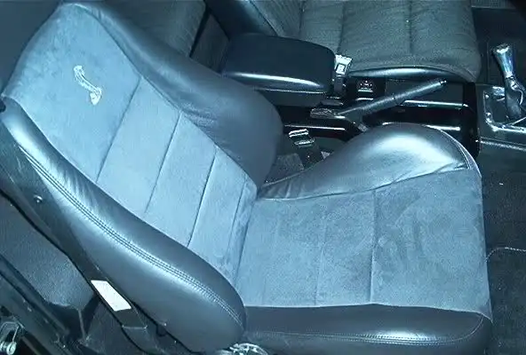

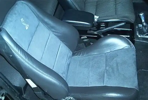

These are out of a 2003 GT. I did not do the swap however, so I cant comment much on the install. I CAN say that the metal seat brackets are new and shiny, and I was thinking they must the ones from the 2003.
they sit up higher but I love it. Waaaaaaaay better IMO:nice:
