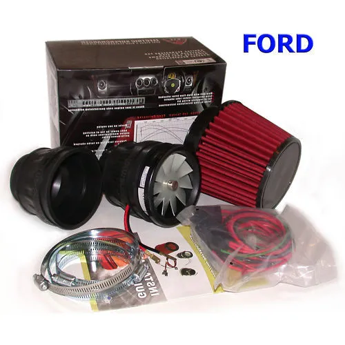

I'm running the Tork Tech setup with a stock pullied Eaton. It get's up to 7psi and dynoed 378rwhp/382rwtq. This is on my stock long block 01GT, with a 5-speed and 3.73's.
I went with this kit because I could get the parts little by little since the boss (my wife) wasn't about to let me drop $5k+ at one time. I'm glad it worked out this way because the install is clean and as mentioned earlier it's upgradeable. The factory Eaton blowers are known to be reliable which added to the appeal for a daily driver. I even hooked up the EGR using a Cobra valve and manifold tube (just in case I need to pass emissions sometime in the future).
The car is a blast to drive, and acts like it did stock until I put my foot into it. I've taken it to the track once but I was on 255's and my clutch was on the way out (just replaced that yesterday). Even with those limitations and my not being a very good driver the car ran 13.5 @ 108mph. With that speed I should have a much lower ET.
You can't go wrong with the TT kit, especially since you could go with the full Magnuson kit if you chose.
:D
