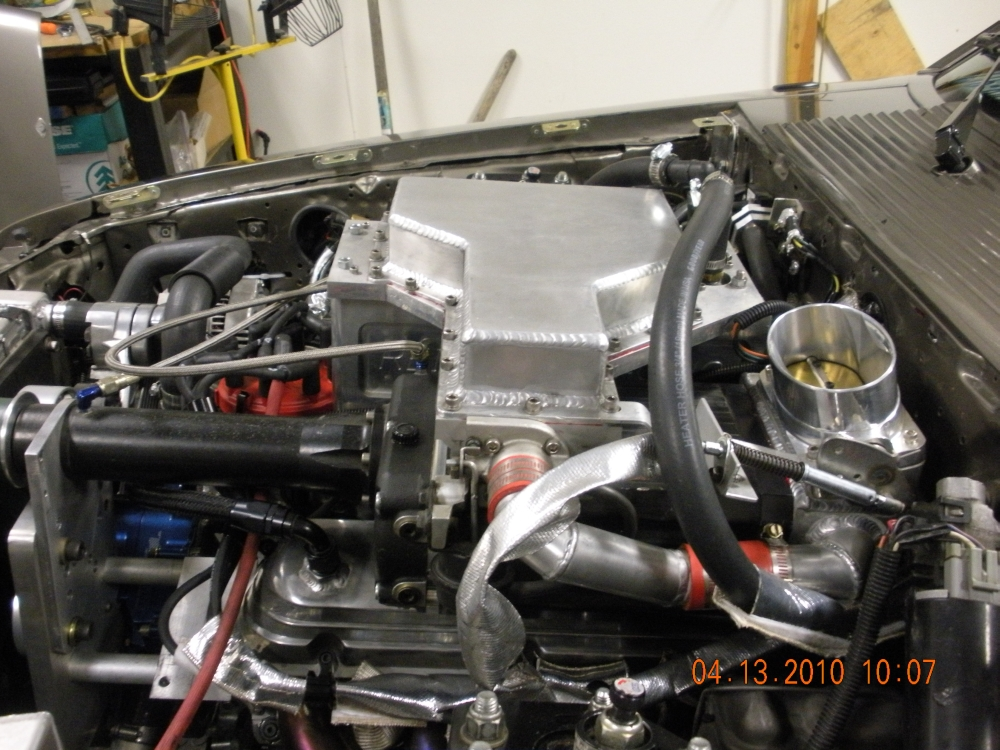

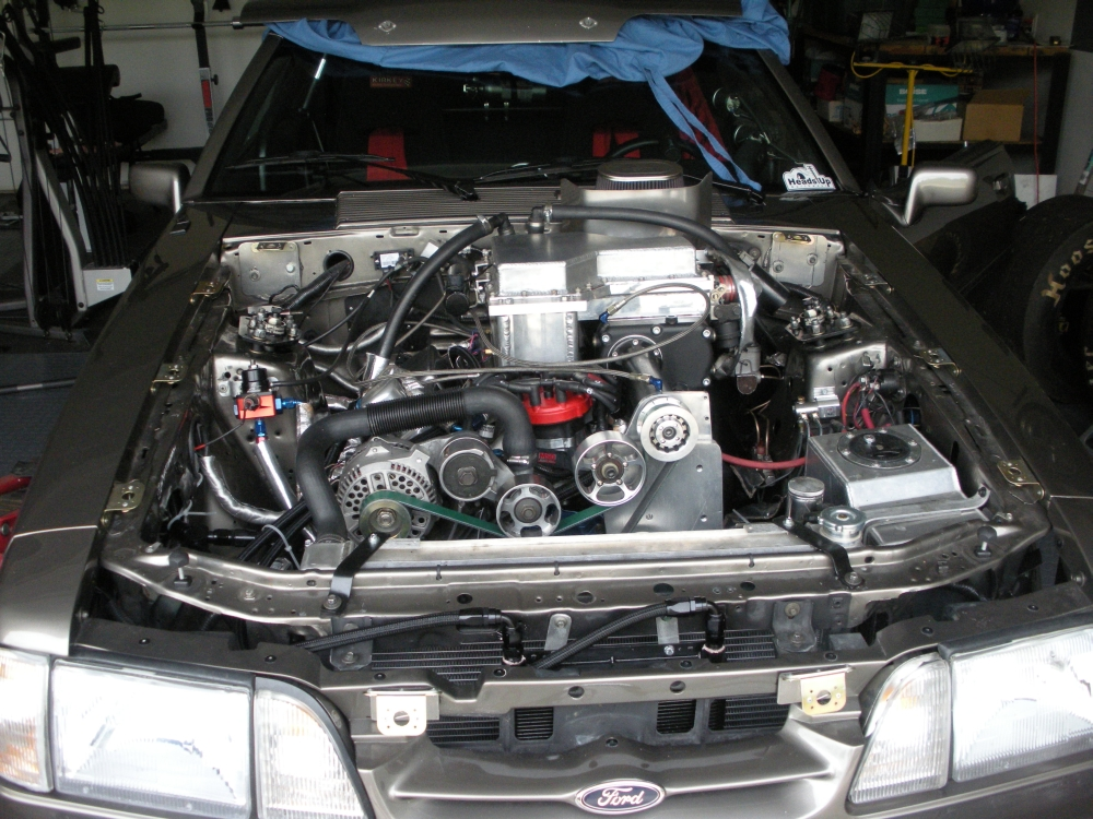

Only if your limitations are running sub 9.8 sec in the 1/4 mile. We went 9.87 in the 1/4 with a 2.1L Kenne Bell in a 3400 car with a 26x8.5 tire. So don't sell the 2.1L blowers ability short. This blower can put out near 20 psi on a 331 cid small block. So the limitations of the 2.1 are more with the person putting the car together than the supercharger itself.
did you do this with the stock 2.1 inlet or a custom sheet metal piece. how did the iat's look? what pulley combo were you using?
That’s kind of an unfair statement, when you consider how far removed the Kenne Bell kit on your buddies car is from what was sent to you in the box the day you bot it. A more fair statement would be it isn’t the limitation of the person putting the car together, but he limitation of the kit the blower is supplied with. Remember, we're talking the modular kit here, not the OHV.
As far as the 2.1L kit for the modular go, around 500whp seems to be the magic figure when it comes to spinning this blower within its maximum efficiency range and even then, that's with a tank full of race gas and ACT’s as high as 220-degree’s by the end of a run in most cases. These compressors don't seem to like to be spun really hard on the more restrictive top end of a 281ci mod motor. Most guys I've seen are lucky to break 450whp on pump gas....and that's with a host of other bolt ons. I don’t think I’ve ever seen anyone surpass 20psi on a 2.1L Modular kit the way you guys are with your OHV kit. They just don’t have the capability with that compressor with what Kenne Bell has given owners to work with.
If I recall, the kit you guys are running is fairly heavily modified with a custom intake, A/W intercooler, loads of timing sucking back a steady diet of C16….amongst other things. Not exactly the route your average owner is willing to take when it’s far easier to upgrade to the larger compressor . Not to mention feeding a heavily breathed on 331ci engine to produce far more power at lower temperatures than your average stock or bolt on SOHC 28 is.
So, for the intents and purposes of this conversation (and most realistic expectations) I’ll have to agree with usaf_branham. Power with the 2.1L compressor is going to be limited with this kit, so if power ranges beyond 400whp are the goal on pump gas, in a daily driver with go with the 2.6L, or Tork Tech 2300 TVS blower.
...and even then 550-600whp is going to be a stretch through stock 2V heads.
There's nothing stock about his inlet. 95% of it is custom.

It's a stroked Windsor, not a modular.
Some valid points to be sure, but that is like saying if you want 400 HP don't use a 302 because as it came from the factory, it just won't get there. You have to opt for the bigger 351W or larger to get the 400 HP because it came from the factory better equipped and can be done without the level of mods a 302 would take. My point was and is: it is not the supercharger that is the problem. God forbid anyone think outside the box.
I have a N/A 325WHP 4.6 that a 2.1 Kenne Bell would easily take to 450 plus WHP without trying hard on pump gas. Would a 2.8LC do it easier? Yup, but it can also be done with the smaller 2.1.......even without heavy modification like on the race car.....by the way the race car made over 700 WHP with the 2.1. with the 2.8 LC it is making closer to 925 WHP and there is still some room for improvement.
I don't disagree with that statement. My only gripe was you seeing this as a user problem, when it in fact it isn't. You guys didn't just think outside the box....you guys tore it down to the ground and rebuilt it completely. I'm going to say that 99% of the people buying these kits aren't lacking the imagination, but frankly aren't going to have the means, or the funds to get that extensively into their build up.
Heck, I myself took a 3rd GEN Eaton M90 into 1.7L twin screw territory with the "outside the box" thinking I performed on my last car....but its not something I would recommend to your average user.
My point is that the limitations that are holding these builds back aren't the blowers, or the builders, but the materials Kenne Bell themselves have given their users to work with. Small intercoolers, limited intake and inlet volume, etc. Combine that with the small cubes and limited head design of the 4.6L SOHC and you see that only so much can be done with what you have to work with. So when you consider how much has to be changed to achieve big power levels on these modular, going with the bigger compressor isn't only the easiest route, it's by far the cheapest and most practical. If anyone was suffering from short sightedness in this venture, I have to say it was the designers at Kenne bell for leaving so much on the table when constructing the rest of these kits.
