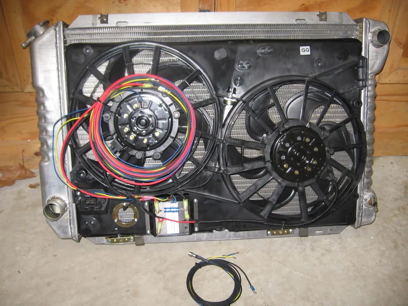

Here is the Contour fan on Griffin 2-core rad w/ DC Controller

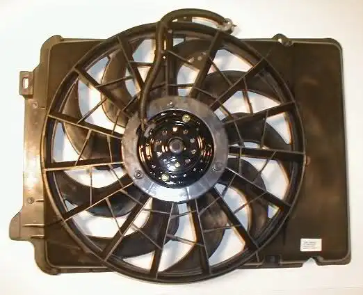

I would go with contour fans only if you are using a DCC controller only cause its a serious pain to effectively control two fans without the DCC controller.
If you are going with a simple thermostatic switch and a relay I would stick with the taurus fan as it is going to be A LOT easier to wire up.
My Junkyard had an abundance of both types of fans, but also keep in mind for the contour fans you are going to be charged for two fans at a junkyard, not one "assembly". No problem if you want performance, but for a budget I think the Taurus is the way to go.
Oh and for looking for the taurus fan just look for the older body style taurus, its probably gonna have the fan you need, you should be able to tell just by looking at it.
Print a picture of the fan and take it with you if you need to, its a pretty distinct fan.
