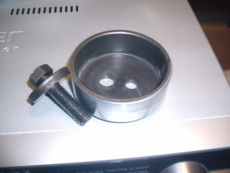

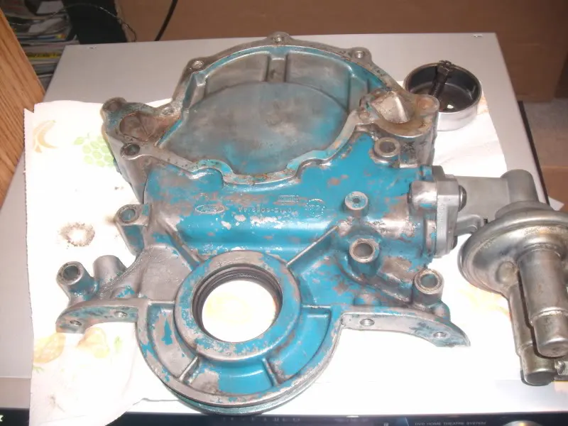

I tore down the old 289 I got for parts and got the timing cover, fuel pump, and eccentric to use on my '98 302 engine. I believe I have the 1 piece eccentric. I know I need to change the timing chain and gears on the 302, but is there any particular engine I can order it for, like just a 289? Anything to watch out for when picking one out?

I used the ford motorsport double roller timing set in my 289. The one piece fuel pump eccentric that you have will work perfectly. Most of the issues that I have had with eccentrics have been with the two piece ones not spinning properly on a cam gear designed for a one piece. So, you could probably use whatever timing set you want with the one piece. Hope this helps.
