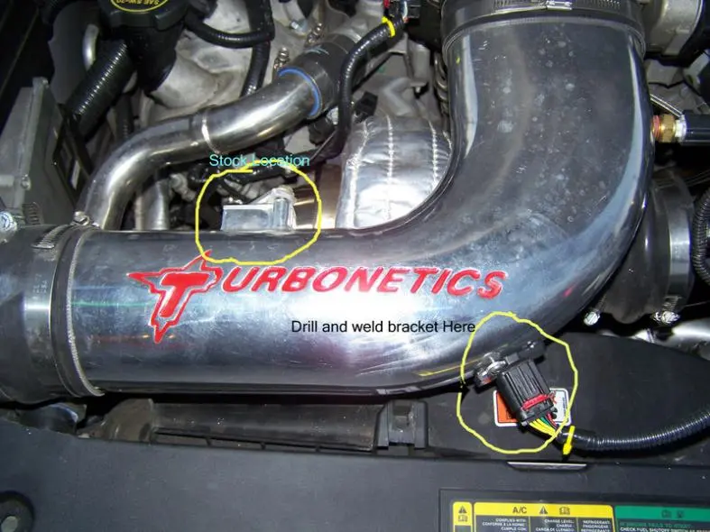

I am sort of leaning towards the turbo horsepower kit. I have heard people were having problems with tuning the turbonetics kit because of bends in the pipe in relation to the MAF. I am also concerned about hitting the pipes. I lowered my car about 2" with BMR springs, and sometimes bottom out as it is. Are there any known clearance issues with these kits. The reason I am leaning towards the turbohorsepower kit is because it is about a 1000 cheaper, and i figure i can use that extra money towards a rotating assembly.

Someone else could probably explain it better than me, but it's mainly in relation to where the MAF is located. A draw through design has the MAF located near the air filter, before the turbo/intercooler, drawing the air across the sensor. It also has to recirculate the air from the blow off valve, back into the intake tract because that air is already metered. A blow through design positions the MAF after the turbo/intercooler closer to the throttle body, and you can vent the bov to the atmosphere because the air from it isn't metered yet. The problem I ran into with the blow through design was the pipe before the MAF needs to be free of bends to reduce turbulent air flowing across the MAF giving it inaccurate readings. There have been people who have relocated the MAF from the stock location on the Turbonetics kit and were able to tune them that way, I didn't get that in depth with it, but you can see where the blow through design would give you more accurate readings because it is "sampling" the air just before it enters the throttle body. Hope this helps, John. :shrug:

Here's a pic of where to move the MAF to make the blow through design tunable.
